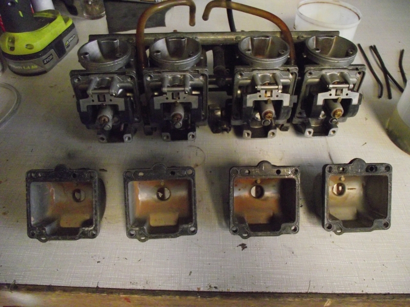

No no no ... i get air sucked from my drain screw... they are in bad shape! (and they don't come in the complete carb rebuild package...at least no from Z1enterprise !)
Do you really think i will be dumb :silly: enough to plug that on the overflow ... you also have a clear picture in the FSM that the guy connect it to the drain :laugh:
Remember i did the wiseco pistons job myself...why i would be dumb enough for the rest :silly: :silly: :silly: hehe i will take that as a compliment :whistle:
BS series carbs don't have overflow circuits,
I have 2 unconnected barbs that are the level of the float bowl... i asked last year about that seems to be the overflow.. just they don't have tubing attached to it.
These carbs are not mine (just to show i'm not crazy :pinch: ) but they are the same... you have the fuel line in the middle then 2 other barbs between a set of 2 carbs... don't know why he connected them but barbs are there

the two other 'barb" are vent lines not overflows
