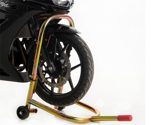

you can't use one of these stands tho now

And how does that stand even work? Looks like it just rests on the bottom triple?

it has a stud that fits into the hole that is in the bottom of most steering stems.
that way you can use the stand to remove the front wheel.
used mainly for racers.
no biggie,i was just playin around :silly: .

Ah, got ya! I know you were just playin'
I probably wouldn't use a stand anywho. If I did, I'd probably custom fab a pretty one
