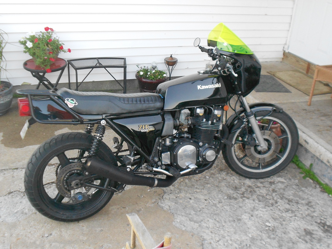

mine are spaced out with some aluminum spacers i machined out and some thin steel sleeves over the threads that came with my progressive shocks.
they have been fine for a few thousand miles so far,and works well enough i haven't done anything better :whistle: .
you are correct sir.

i went one step further and slotted the bottom of my aluminum spacers so i could remove them without removing my shocks.
soooo :whistle: ,
i could use the space for the front mount of my custom luggage rack i built.
it attachs to the shock studs by some slotted spacers welded to the front of the rack and machined out spacers that fit the turnsignal mount holes and countersunk allen heads through the backside.
soooo :whistle: ,

in my defense sir the mk11 is just for the pic of the upper shock bolt :whistle: .it is a sanctuary built bike.
the z1r pics are the same bikes but the pic from the back is right after i rebuilt it from a wreck and the pic with the rack is after i had time to redo a couple things
.windshield,header,seat cover etc.
