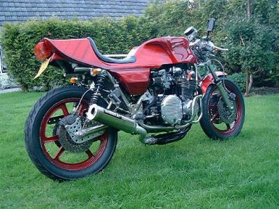

13 Mar 2013 11:32531blackbanshee wrote: i gotta say hollywood that the red seat looks like a single seat and yours looks like you could fit a lil hottie behind you :whistle: .
which ain't a bad thing if you ask me :lol: .
your bodywork has that funky cool 70's vibe.
i love the stance and everything else about the bike.
kinda on the fence over the bodywork tho,it can't help but be cool i think.
i am still waitin to see how you bring it all together with the paint
keep us posted,
