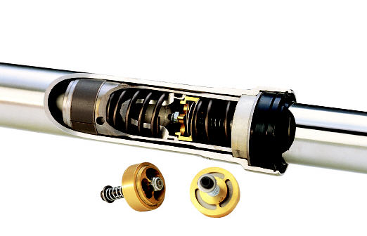

RaceTech Cartridge emulators installed 81 GPz1100 was created by 577nitro
27 Aug 2019 01:02 - 27 Aug 2019 01:03
Finally got around to installing a set of Cartridge Emulators into my forks last weekend, with 10w fork oil. I'm blown away by the difference; they used to bottom out on braking and nose dive, no more. They actually dampen now...high speed and low speed. They were a little too big so I had to turn them down, this allowed me to exactly fit them to the inside diameter of the forks for a perfect seal....which I found out the fork tubes are 5mm thick...thats pretty stout. I'm still tuning them, but overall I'm very happy. I'm trying keep the period correct S1 replica look. Larger modern forks would change that..maybe later down the road I might upgrade them, but for now since I had these, I'm going play around with them. Next thing I'm going to do is get a set of preload adjusters from PMC, and upgrade the springs with the right rate. I think the oil weight could be upped too. I put zip ties around the tubes to measure travel on both. Comparing to the old setup the forks bottomed completely...and "bouncing" caused sever unbalanced pogoing on the front. ..and at a different rate than the rear upgraded zrx1100 KYB shocks. I'm going to get a fork brace as well to stiffen and stop any independent fork action.
They will never be as good as modern forks, but, they are 10 times better than before.
Downside, to adjust them you have to pull the emulator out...and it can only be adjusted for compression. Rebound is adjusted using oil weight. I'm looking at ways to modify the emulator for rebound.

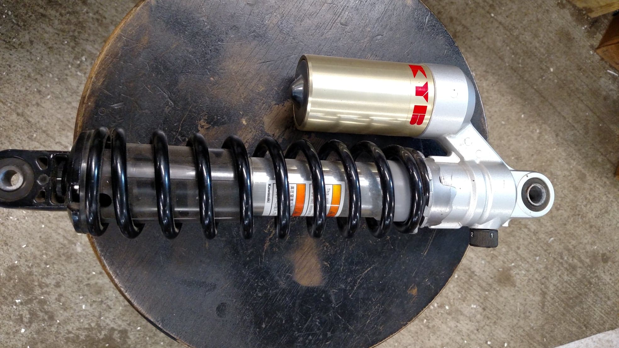

We're using KYB's shocks off of a ZRX 1200, the wheels are 2017 R1's, having the outers polished and the centers painted to match this gold on the shocks.

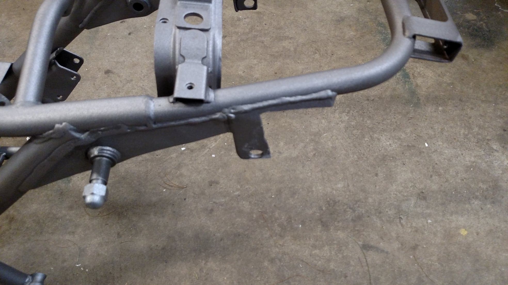

Motor is getting powder coated black, hoping this will be on the ground running before end of month. I got the frame back today from blasting, start adding gussets and trimming off unnecessary tabs and brackets. Someone had cut the rear turnsignal mounts off, if any one has a bad chassis that they could cut the tail off of, I'd be interested in it.
