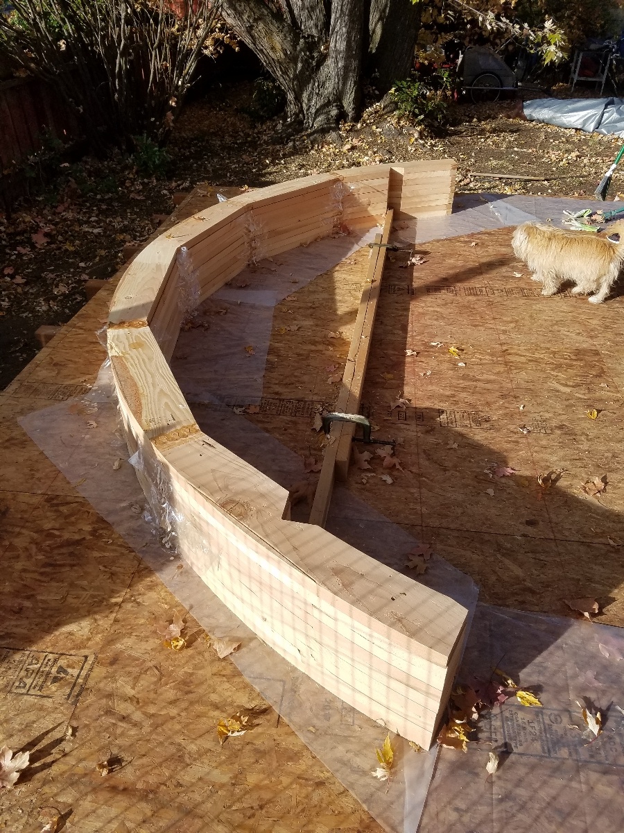

Here's a picture of two boards, one of which must be flipped end for end to be joined.
Until now I'd only used bulb joints to make picture frames and various cabinet / fixture types of projects. This fall I decided to venture out into the realm of structural applications by building an 11' by 16' shed that will have a barrel shaped roof. The picture above is of two 2" by 8" pieces of Douglas Fir that will join four other pieces to make one complete arched rafter.
Here are the rafters joined together and stacked on the floor of the shed.
Here's another picture of a few sections joined together on my work bench.

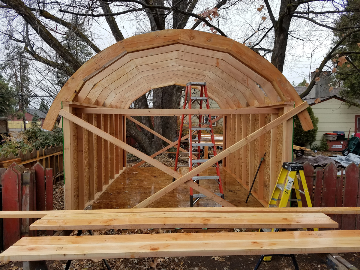

I've been working my butt off to try to get under roof ahead of the winter weather. Didn't make it. No snow yet but it can't be far away. I did get all the rafters up today and managed to pull a tarp over the whole thing. Still got to add the barge rafters (Gable Facias) before I can sheet the roof.
What do you think?
What do you think?

A modern Quonset hut,
That's a great idea for a joint Bill.
Are you using a urethane glue?

07 Dec 2017 20:08 - 07 Dec 2017 20:15Actually I doubt that it'd ever be a marketable idea given that each section took 45 minutes to machine out on a CNC router. Even if I optimized the the code, I doubt that I could shorten the time to less than 30 minutes. There are nine rafters with six sections per rafter. Fifty-Four times Thirty minutes each is still Twenty-Seven hours just to cut out the parts. No I did it just because I imagined it and I imagined that I could do it. That's not meant to diminish your compliment. Thank You!Street Fighter LTD wrote: Nice Bill

I considered using urethane glue but I've had issues with it foaming up and separating the pieces. In the end I used TiteBond Type III, which is supposed to be water proof. I called Franklin Industries about their "Not for Structural Applications" disclaimer and was told "Why should we accept any structural liability for a two dollar bottle of glue." When he turned, with the other side of his face he said that folks use their glues for structural applications every day but if I wanted to I'd best hire an engineer.bluej58 wrote: A modern Quonset hut,
I also checked on resorcinol glues only to find that they're hard to get, with manufacturers wantin to only let certified users purchase them.
