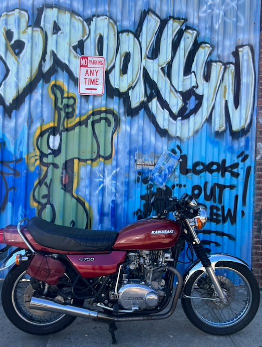

29 Mar 2023 17:40Took the bike out for a spin and then took off the tank. Currently soaking in Evaporust. I only bought a gallon and am rotating the tank ever 45 min.Rinse the tank with water then spray a bunch of WD 40 into the tank. The WD 40 will penetrate the water and coat the tank. Drain the tank upside down and let it dry out. I've done it dozens of times and never had any flash rust. Later, after the tank has dried out a quick rinse with gasoline and you're ready to go.
Bill
From earlier today:
