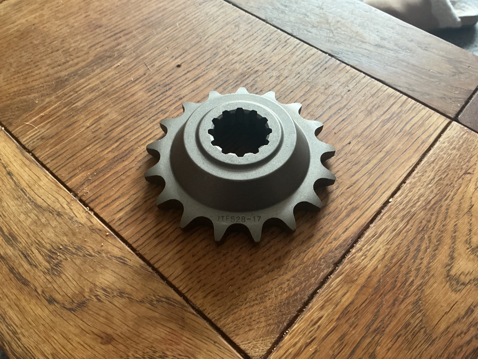

You can buy splined spacers from webike or use a couple of splined tab washers. How much offset do you need? I got a 19mm offset sprocket made for my 1100 wasn’t cheap mind but better than spacers in my book.
i have a spare sprocket it might be off a zzr i can’t remember

That depends on how thick the splined flange on the sprocket is, I could fit a 3mm spacer and a tab washer behind the sprocket and fit a tab washer behind the nut on my gpz 1100 unitrac

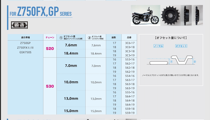

Webike Japan offers a 530 conversion sprocket from XAM with either 16 or 17T for $46. Shipping is a measly $53 though. Ugh!
Click here…
