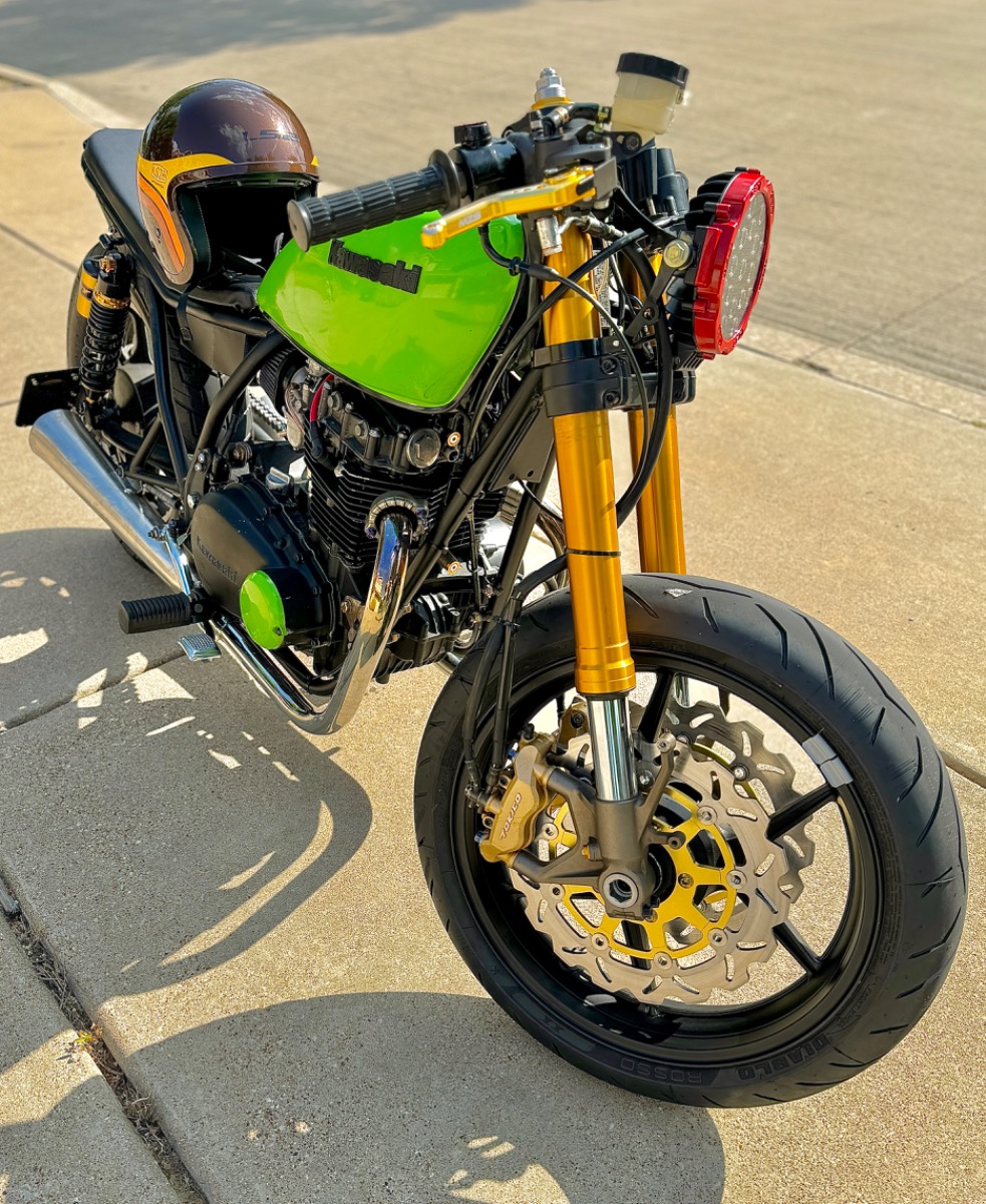

Re: Triple tree custom work
15 Jul 2024 21:55
The following user(s) said Thank You: Street Fighter LTD, Scirocco
16 Jul 2024 02:58
Your bike looks great (i love that green)!!!
23 Jul 2024 17:22
Smoking Hot Custom
