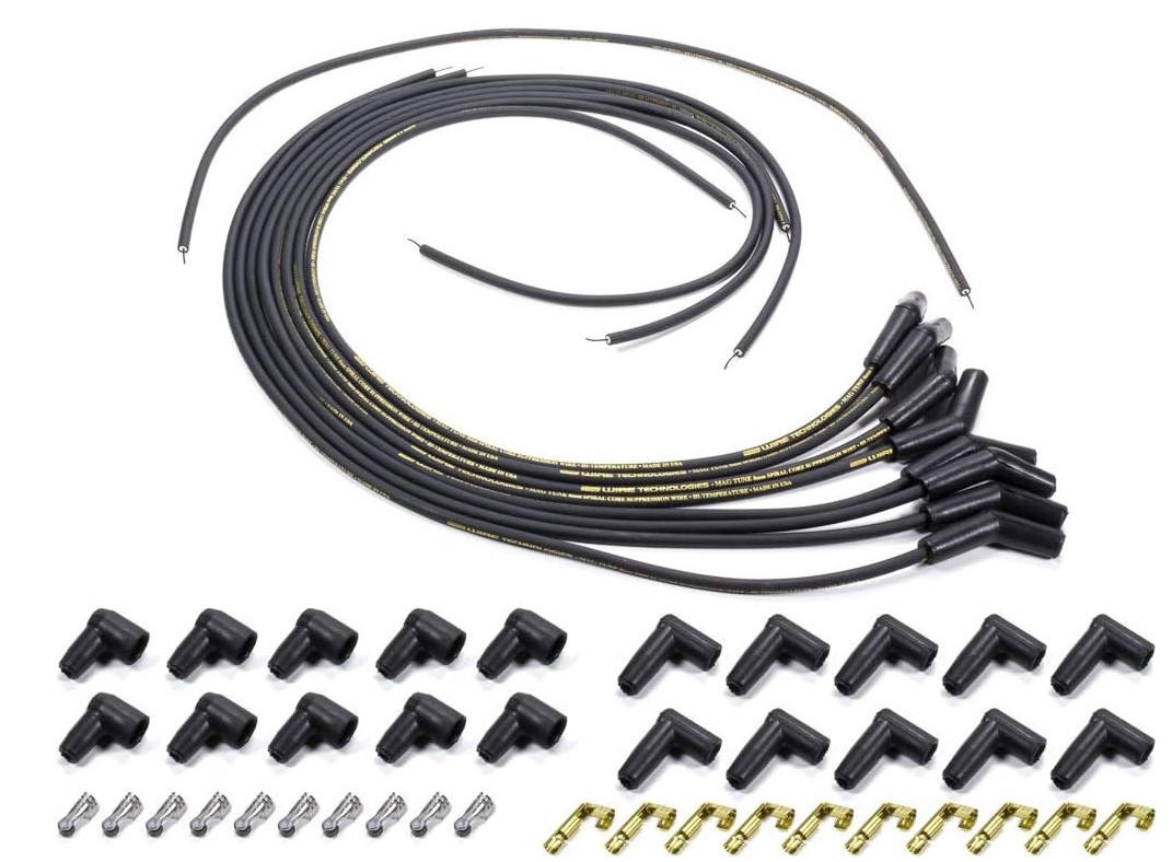

I stopped using Dynateck motorcycle wire kits over 15 years ago, I find them expensive for what you get. I usually look for deals on either MSD or Mallory V8 car 8mm wire kits with 135 degree boots.
With one kit you can equip two bikes for less than the price of one Dyna brand kit plus they give you a extra wire for the car coil and extra boots and metal connectors. You can cut to fit as they have extra long wires not required on Kawi engines.
Since both makes are aftermarket high performance used in racing you can pick and choose your core material plus they never come with resistors in the boots. The fixed 135 degree end boot is perfect for our heads.

08 Oct 2026 09:07Indeed but only 700 ohms total for the cap and lead so much less than regular resistor capsThose sound like the suppressor type, with resistance.My Taylor leads have the fiberglass/carbon cores
