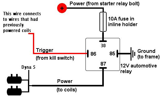

I will try the relay solution - so to eliminate any voltage drop from the starter button or kill switch, today.

Hi, I have used silicone leads with Dyna ignition and the wired George relay set up. Starts on first press of the start button, great spark and runs extremely well. Definitely recommend wired George relay set up as you will get correct power to your coils.

Copper multi strand core ht and wired george relay mod to eliminate voltage drop from the 50 yo loom and swiltches.

Before installing a relay, run a wire straight from the battery to the coils and see if you get stronger spark. If not, a relay won't help.
Note: Once the bike is started this way, you will have to disconnect the wire to shut it off.

Thanks for the reply! I just bought a new wiring harness, so I'm hoping that would perform better than the old one.
I also am a fan of copper core leads, but since I already have the silicone ones fitted, I might as well try the relay option first.
