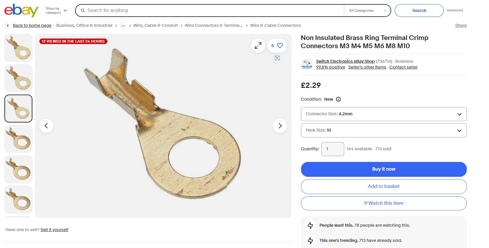

But they are not open barrel I have understood is the best to use? Or?

09 Jan 2025 03:50
These don't look bad and you can order the size and quantity you need rather than a multi-pack (most of which you will never use)

09 Jan 2025 04:03 - 09 Jan 2025 04:05
Thank you!
