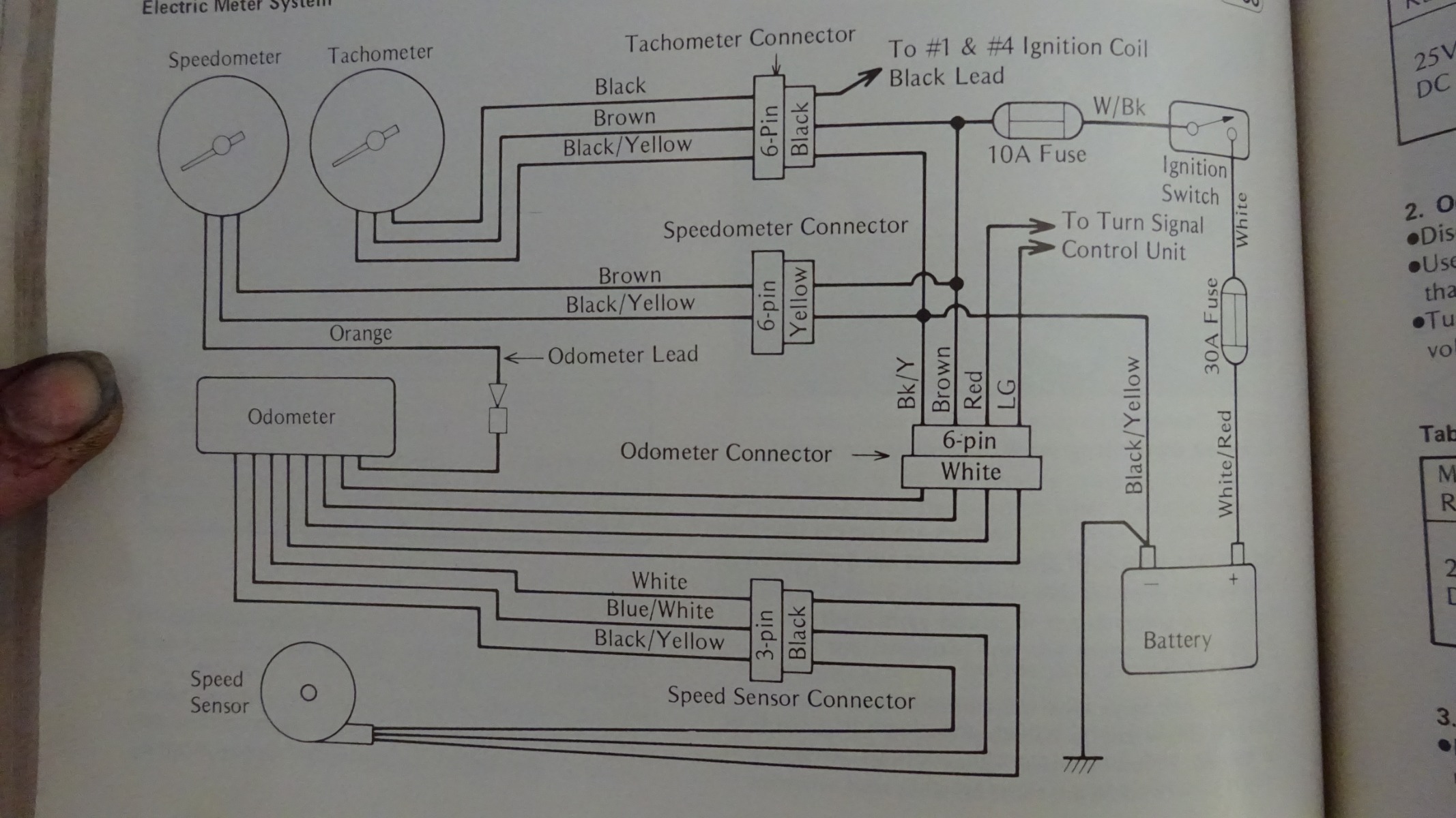

I don't have a wiring diagram for an 83 1100 shaft, and I'm not sure which shaft model you are referring to. I assume it's the '83 1100D2? spectre in your signature?
But I do have a few difficult-to-read diagrams from 1100's showing the tach and voltmeter.
81 1100B1 gpz
82 1100 gpz
82 1100D1 spectre
84/85 Zn1100B1/B2 Ltd
Some show separate meters and some show a button to use the tach as a voltmeter.
(The Zn1100 diagram from a Clymer manual has a pretty serious error in the tach/volt button in case you come across that diagram online.)
In all diagrams, they show these wire colors for the tach:
Black is the tach signal from the 1-4 coil.
Brown is 12v.
Black/yellow is ground.
None of the models shows a red or green or yellow wire to the tach or voltmeter.
81 1100B1 gpz
82 1100 gpz
82 1100D1 spectre
Brown is 12v.

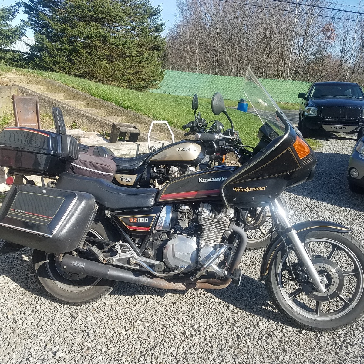

The pic in the profile is not the bike I am having the issue with, it is an 83 kz1100 shaft A1 as in the pic here...

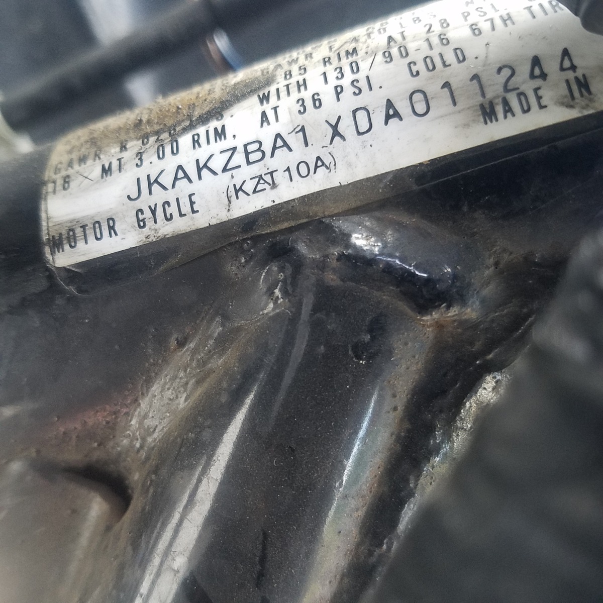

My bike is not with me right now for me to check mine. It shows the 6 pin (tests 1,2, and 3) in the head light housing and the green red and yellow (test 4) inside the gauge housing.
You don't see the plug is the problem correct?
Also it's an A3 not A1 based on the VIN
