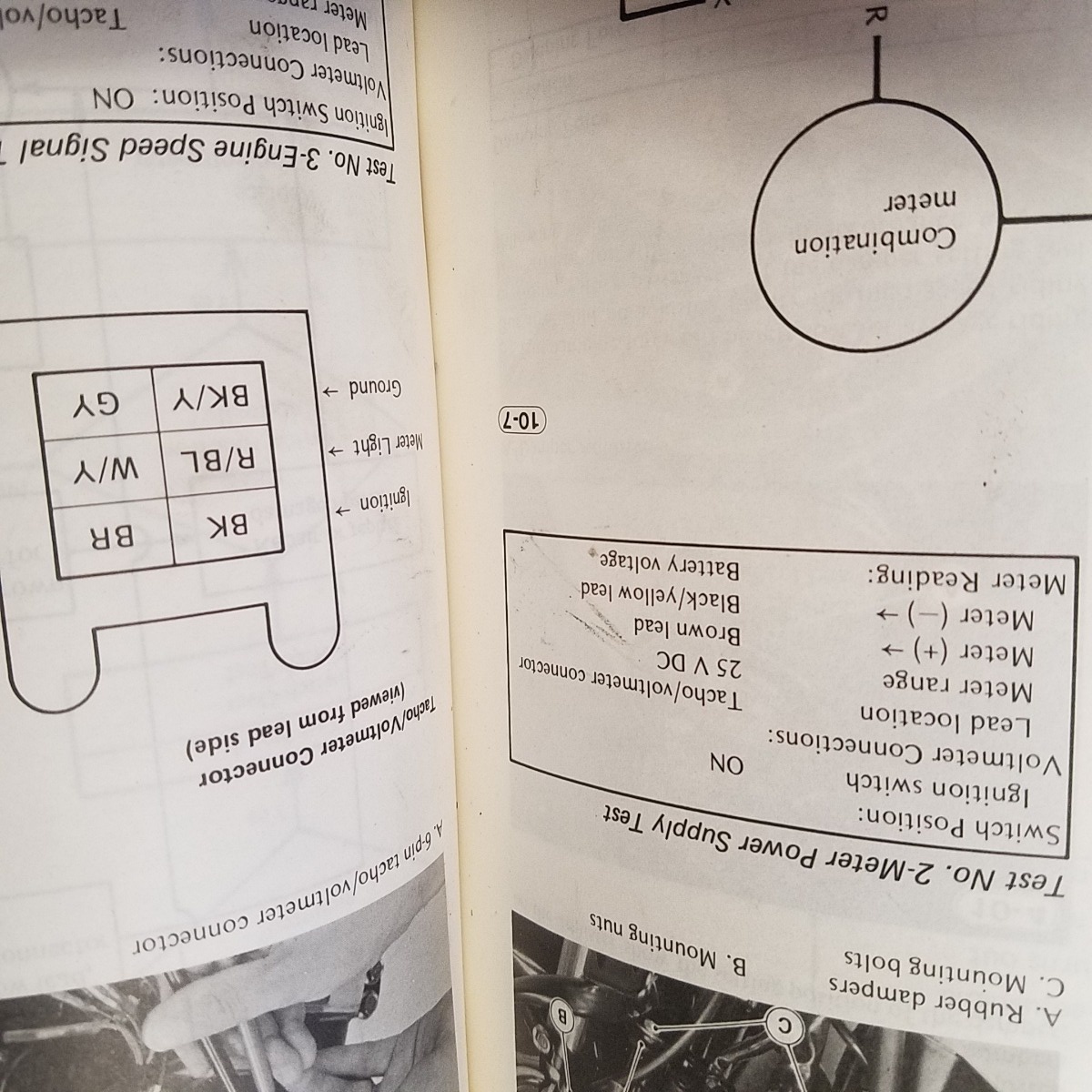

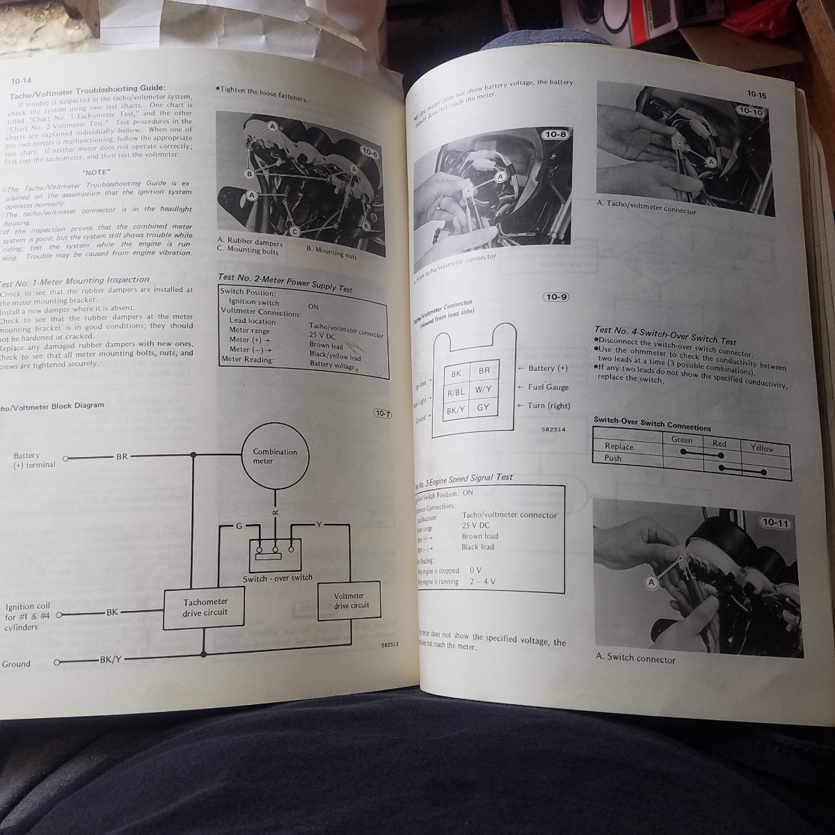

I am trying to figure out an erratic. bouncing tach needle and inop voltmeter issue on my 83 kz1100 shaft. I went thru the first two test in my manual and everything checks out so far. Onto the third test which is to test the push button tach/volt switch. I am stumped here. It says to check contunity between red, green. and yellow. I cant see any red, green yellow within the group of wires going up into the gauge cluster nor can I see the connector referenced in the pic on the manual. I have included pics of my manual and the test described within. Do I have the correct manual? Is that red, green, yellow connector up in behind the cluster requiring cluster removal? Anyone have similar issues and have any input on how to fix it? The bike still runs, starts, and charges fine and all the fuses under the seat check out.

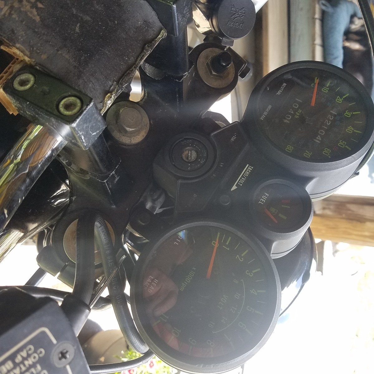

The pic in the profile is not the bike I am having the issue with, it is an 83 kz1100 shaft A1 as in the pic here...

The red, green, yellow wire and connector is from the tachometer/voltmeter troubleshooting section of the manual.

This is the cluster on the Spectre, which is the same as the kz. I cant find the red, green and yellow wires or connector on the spectre either.

page 10-15. the image that has me befuddled is on bottom rite of page, image 10-11

My manual has that same image on 5-32 as yours.

My bike is not with me right now for me to check mine. It shows the 6 pin (tests 1,2, and 3) in the head light housing and the green red and yellow (test 4) inside the gauge housing.
You don't see the plug is the problem correct?
