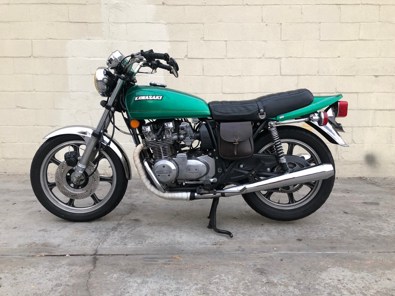

Was on my KZ650 after letting it sit for 2 weeks.
Was on the highway here in NYC and turned on the lights as it was getting dark.
Bike went along fine and then stopped. I still had power but when I tried to use the starter button, I got nothing. Didnt even try to engage. A completely dead button. But I DID notice the red OIL button, or Power button, or whatever, in between the speedo and tach, seemed to blink when I did this, or go dim.
Embarassing, as had to walk the bike a 1/2 mile off the highway. Pulled over, kicked it, and the bike started. Rode it for a for more miles and purposely turned it off as I wanted to test the starter. Pressed the starter button and it started right up.
Does this sound like a bad battery, because Ive had battery issues with this bike before.
Also. SOMETIMES, coming off a light, when I roll the throttle, the bikes hesitates, then seems to jerk backward, or jolt (not sure how to explain it) and then its fine. This only happens sometimes. but more than I would like. What do you think it could be? Carbs were just cleaned COMPLETELY etc.
