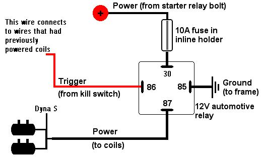

Greetings All,
I have recently tried the wired George mod on my 78' KZ650 due to the lack of voltage going to my coils. I installed the 10A inline fuse as recommended but when I turned my key on the fuse blew. After several attempts with the same result I increase the fuse size to a 20A. After about 50 failed kicks (I believe my starter clutch is bad) I decided to take of the engine side cover and smelt a burning plastic smell. This is when I noticed that the points were glowing red and eventually melted the metal in the locations shown on the attached picture. Can anyone help me with what I may have done wrong? Thanks in advanced.

Sounds like you have wired the relay terminals incorrectly or have a bad relay. Your live must be going dircetly to earth to blow the fuse like that.

The description leads us to believe +12v is going straight to ground through the points. That is, the points are at full battery potential without any load (the coils).
What are the colors of the wires in stock wiring harness going to:
The relay coil terminals (where are you picking up voltage and ground to energize the relay coil)?
The relay common terminal (where are you tapping into battery voltage to power the coils)?
The relay NO terminal (where are you sending voltage taken from relay common when the relay coil energizes and the NO terminal closes)?
As an aside, if the points were glowing red they're probably shot. 20 amps is waayyy too high for the load fuse.
We're running 7 amp fuses on the load side, 3 amp fuses on the relay coil side our Z1's with the coil relay mod. They're over-fused at that.
Good Ridin'

Rather than do the WG mod just sort out the bad connections in the loom that drop the voltage in the first place and you won't need a relay at all.
The "mod" is not an upgrade but a shortcut bodge to mask existing problems in the loom .
Then get rid of the points and fit a Dyna 'S' to solve all your ign problems for good.
