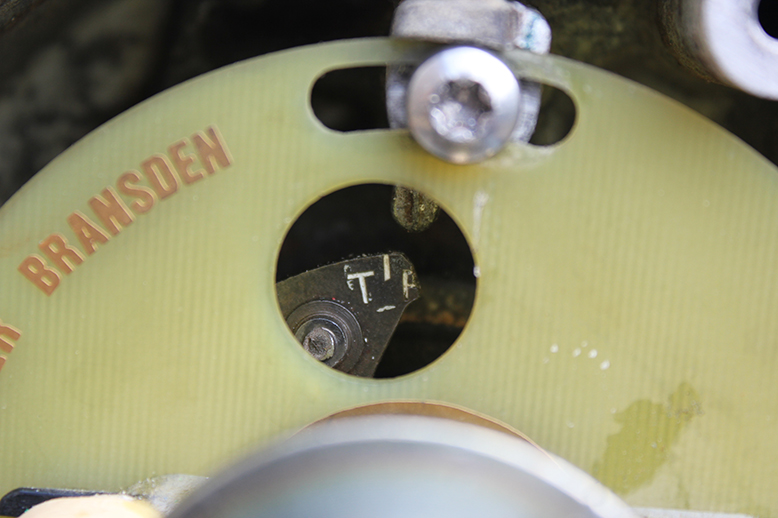

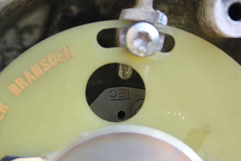

Patton and Nessism - Thank guys. You're all right! it is really tight. I made a video and took few picrures to you guys have a sense of what is going on here. By the manual, it should be between 0.8 ~ 0.18. But is tighter than that. In the video you can see more details.
Any idea how to fix it? A link or tips to untighten those guys are more than welcome
And few other details about the points.
Somehow, I thing something wrong went here, dont you guys thing?
I will continue checking the eletrical sistem but first, let get those valves right before I jump to next part.
Thank guys

Hello zell
The screw heads at your pick up plate are called TORX
It looks like the PO or something else had had broke some parts of your timing advancer unit.
Michael
Michael

Zell, you mentioned points and provided a picture; BUT those are not Kawasaki points. In fact, I don't believe that ignition is any kind of points. It appears to be a Boyer - Bransden electronic ignition. Consequently, you will need the instructions for that Boyer - Bransden if you plan to make any adjustments to it. Also, it looks like it may be damaged, but I cannot say for sure if it is or is not. Ed
The following user(s) said Thank You: zell
