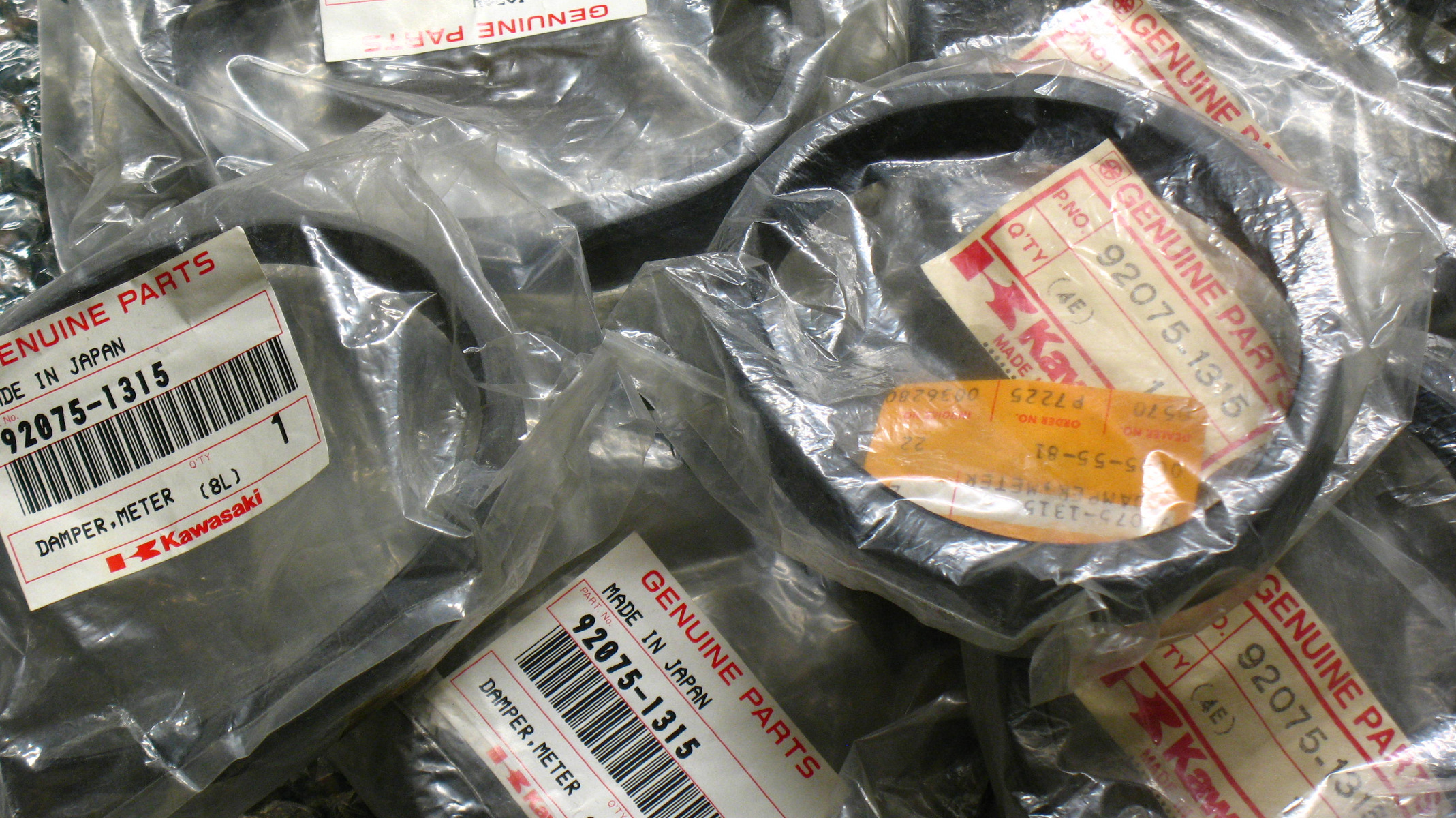

My old dampers were like that, and I found using an oil-filter cover o-ring took up the slack. It wasn't perfect, but provided the much-needed support...fit just under the SS retaining ring, and stretched over the top of the gauge without having to remove anything.
Just don't over tighten the center bolt at the back, since the post support can be easily broken off.
After I found this set, that old business went to the circular file.

05 Mar 2019 09:11 - 06 Mar 2019 13:28daveo wrote:GPzMOD750 wrote: It's official. I just got the refund and NLA message.
I was thinking of getting some delrin and turning it to a facsimile of the damper contours with just enough room to put a layer of silicon wrap under it.
Anyone still need a set of 92075-1315 meter dampers?
