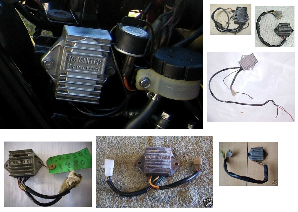

Perhaps an IC Igniter is being mistaken for a "cdi box."
Here are some examples of various Igniters.
If not already done, would assure that the black/yellow wire to/from the igniter is providing a good ground.

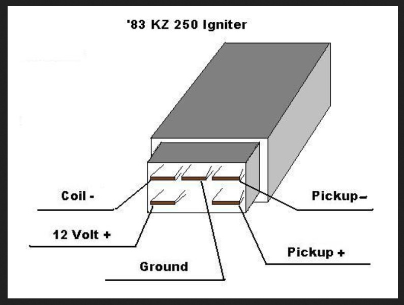

I'll check the black/yellow wire
Attachment 1008150123b.jpg not found
- Posts: 18564
- Thanks: 2103
- 82 kz250l
- Posts: 52
Re: 82 kz250 weak no spark
08 Oct 2015 05:57
That's the same as mine.....the coil ohm out good so I should look in to the ignighter?.....if so is there any test I can do on it?.....thanks for all the help
