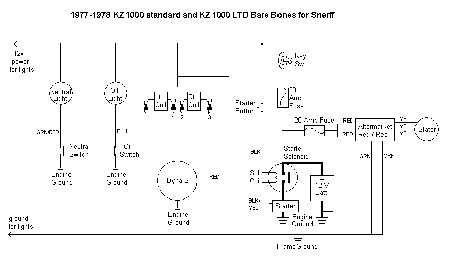

snerff wrote:
Hi to all. I could use some help on the bare bones wiring subject. I have a 1977 KZ1000 engine. I will be using it in a 2/3 scale WWll jeep. I need to do a bare bones wiring on it. It just needs to run and charge the battery. I am having a hard time finding someone locally to do that. Any help would be appreciated. I will post pictures on the build if I can ever get this engine running.
Thanks for your help, this is a great site.
Starter or no starter?
Here's both
More
25 Apr 2008 23:57 #209174 by snerff
Replied by snerff on topic 1980 750H bare bones for mattylight
really appreciate this, saves me a lot of headaches, thanks again.

26 Apr 2008 00:34 - 26 Apr 2008 00:36 #209176 by snerff
Again thanks for the great diagram on the KZ1000. I do have one last question. The points were replaced by a Dayna s. How would that fit into the diagram in place of the points? I hate to sound dumb but I did get confused about the points wiring. The wires out of the engine cover are red black and white.Thanks again.

26 Apr 2008 22:55 - 26 Apr 2008 22:57 #209381 by loudhvx
Replied by loudhvx on topic 1980 750H bare bones for mattylight
Are you sure it's red, black, and white?
The instructions for the Dyna S show red, black, and green.
www.dynaonline.com/downloads/instruct/DS2-1_2-2.pdf
Last edit: 26 Apr 2008 22:57 by loudhvx.

27 Apr 2008 03:12 - 27 Apr 2008 03:16 #209398 by snerff
I hope you do not get tired of this. I made a drawing of what comes out of the engine. 4 wires come out of the dayna s and go into a sleeve with 3 wires comming out of the other end. The only 3 yellow wires I can see come from the item on the right bottom of the page. I think I,m getting confused and thanks for putting up with me.

27 Apr 2008 09:22 - 27 Apr 2008 09:36 #209474 by loudhvx
Here's some ID to what you have. If it's a Dyna S, you may need older or newer instructions. Some Dyna S models did come red, black, white. The one for the Suzuki GS shows white instead of green. Are you sure it's a Dyna S and not just part of a Dyna III ? How old is the Dyna? Did you purchase it yourself, or did it come with the motor?
Also, on the white/red wire from the engine, is it possible it's light green/red? That would make it the neutral switch wire.
I circled the wires which get tied together for the charging system. Each yellow from the rectifier goes to one black from the stator, and one of the colors from the regulator (pink, blue, yellow). It shouldn't matter which color goes to which yellow.
Here's a link to the Suzuki instructions:
www.dynaonline.com/downloads/instruct/DS3-1_3-2.pdf
Notice the black wire is shown firing the 2-3 coil. On a KZ, black usually fires the 1-4 coil. You may have to call Dyna to find out exactly what you have.
Last edit: 27 Apr 2008 09:36 by loudhvx.

27 Apr 2008 09:30 - 09 Jan 2019 15:40 #209478 by loudhvx
I added the neutral light and oil pressure light in case you want them. Also, are you planning to use the starter? If so, you'll need some sort of starter solenoid. You don't need a KZ solenoid, most generic starter solenoids will work.
1977 1978 KZ1000 bare bones for Snerff
EDIT 1/9/2019:
Mattylight Barebones Bare Bones Wiring Diagram
1977 -1978 Kawasaki Kz1000 dyna S for Snerff
Kz 1000
(This was the final version. Intermediate versions are lost.)
Last edit: 09 Jan 2019 15:40 by loudhvx.
