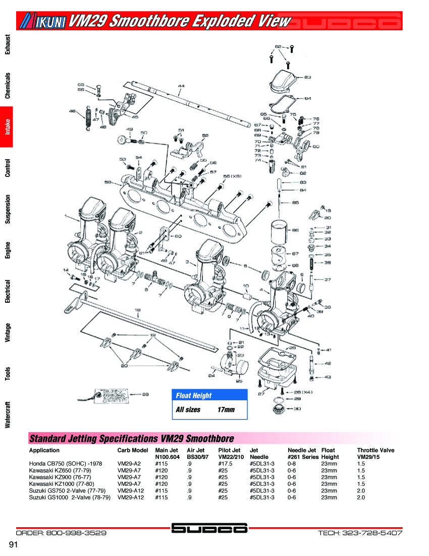

This is from the Sudco Mikuni book for reference. Floats were all done to exactly 23mm as advised in a previous post.

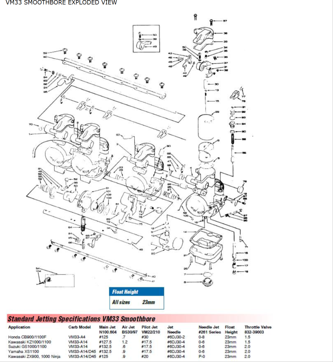

I do not know if any of this will be of help to you or not. But here is a view of the carb parts and a table that suggests jetting for some models, from a Mikuni catalog.
As an aside here is what wiredgeorge had to say about the suggested jetting
"If you are looking for a good laugh, find Sudco's VM29 jetting recommendations and try them out. HUGE main jets, HUGE pilot jets and the air screws cranked out way too far. When I first started jetting 29s, I tried following these guidelines but guess what? hehe
The 29s are VERY VERY similar to the 76/77 KZ900A/B VM26s... same needle jet size, same jet needle size, same slide cut out and the main and pilot jets should be REAL close. The 76/77 VM26 was a bit too rich when back in the good ol' days, the EPA didn't notice. Those carbs will allow a bike to start with little or no choke and you can change to most any pipe without a flat spot.
Air screws on 29s don't behave the same way as on other VM series carbs because of the hole in the screw towards the tip. 1/8 turn out is about right for #17 pilot jets. If you are not fouling plugs then you are not too rich... (pilot circuit)"
