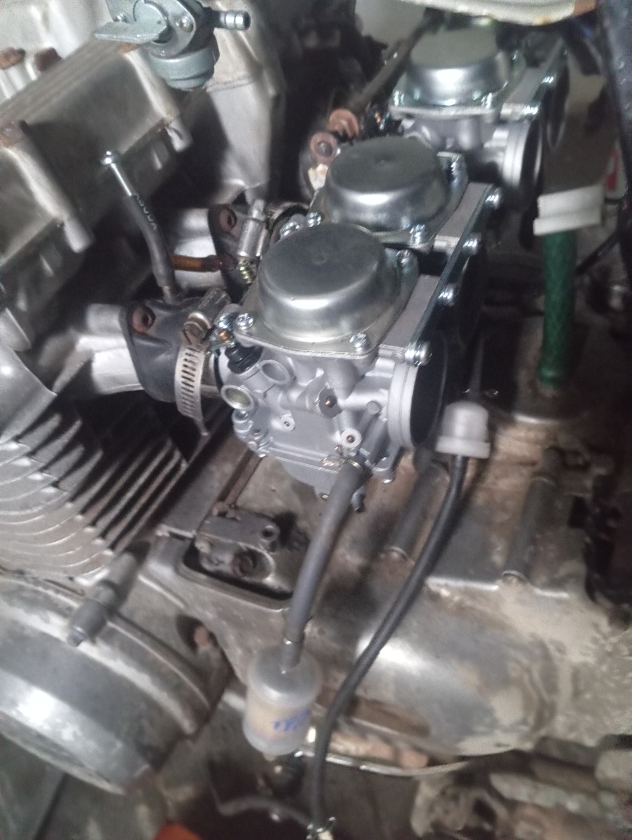

20 Jul 2026 07:41I have an '82 KZ and it's given me a lot of problems with the carburetors. I took them to a mechanic who promised to give them an ultrasonic cleaning, but he never solved the carburetor problem. When I opened the carburetors myself, I realized that he hadn't even given them away, and it's quite likely he hadn't opened them either because they were full of scale inside. I also realized that I removed the air jet that was swept out with a drill bit and put a screw in to try to compensate for that air leak.I've adjusted the carburetors as much as I can, but it only won't run if I set it too high; it starts to overheat, and if I set it too low, the engine starts to run slowly until it stalls. My heart races like crazy, I'm drowning. I've been like this for over two months and honestly, I'm starting to get discouraged.
These carbs look to be an outright disaster. In addition, running without an airbox is a fail, and using worm clamps on some old crusty rubber intake boots are another fail. Honestly, and I mean this sincerely, check the New Owner Things to Know thread for a long list of items that MUST be right before the bike is put on the road. Shortcuts are long cuts, as referenced by these carbs.
Here is a carb rebuild tutorial that will help guide you. There are some details that are different, but the general approach and 90% of the details share between different model BS Mikuni carbs. Also, you will need O-rings and gaskets. Easy to come by stuff, that many people can't be bothered with doing.
gsarchive.bwringer.com/mtsac/~cliff/stor...Rebuild_Tutorial.pdf

I apologize for not replying to this message sooner. Thank you for the information, but I've changed my plans.I've replaced those old, unusable carburetors with a set of two 250cc twin-cylinder carburetors. You can see them in the projects thread. I've already tested them and they just need adjusting.

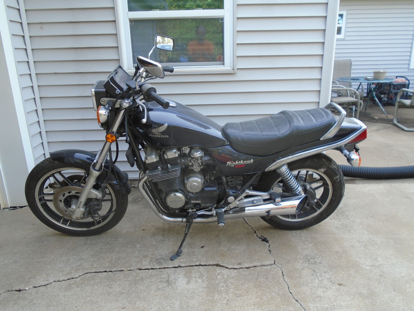

I wish You luck!! I know it's hard to get stuff to your area and you have to do what you can to make do. Like the garden hose breather attachment, mean green and reinforced to boot! Those look like Honda Keihin VE Chinese knockoffs. This style of Keihins were used on the Honda Nighthawk.

If they are indeed from a Honda Rebel 250, it's explained in more detail in the projects thread, although I'm not sure whether to continue that thread there or if I should have created it here in the carburetor section. But as I said, it's a good solution, and I think it would be very helpful, at least for someone who also doesn't have access to the parts, to read everything I'm going to do.

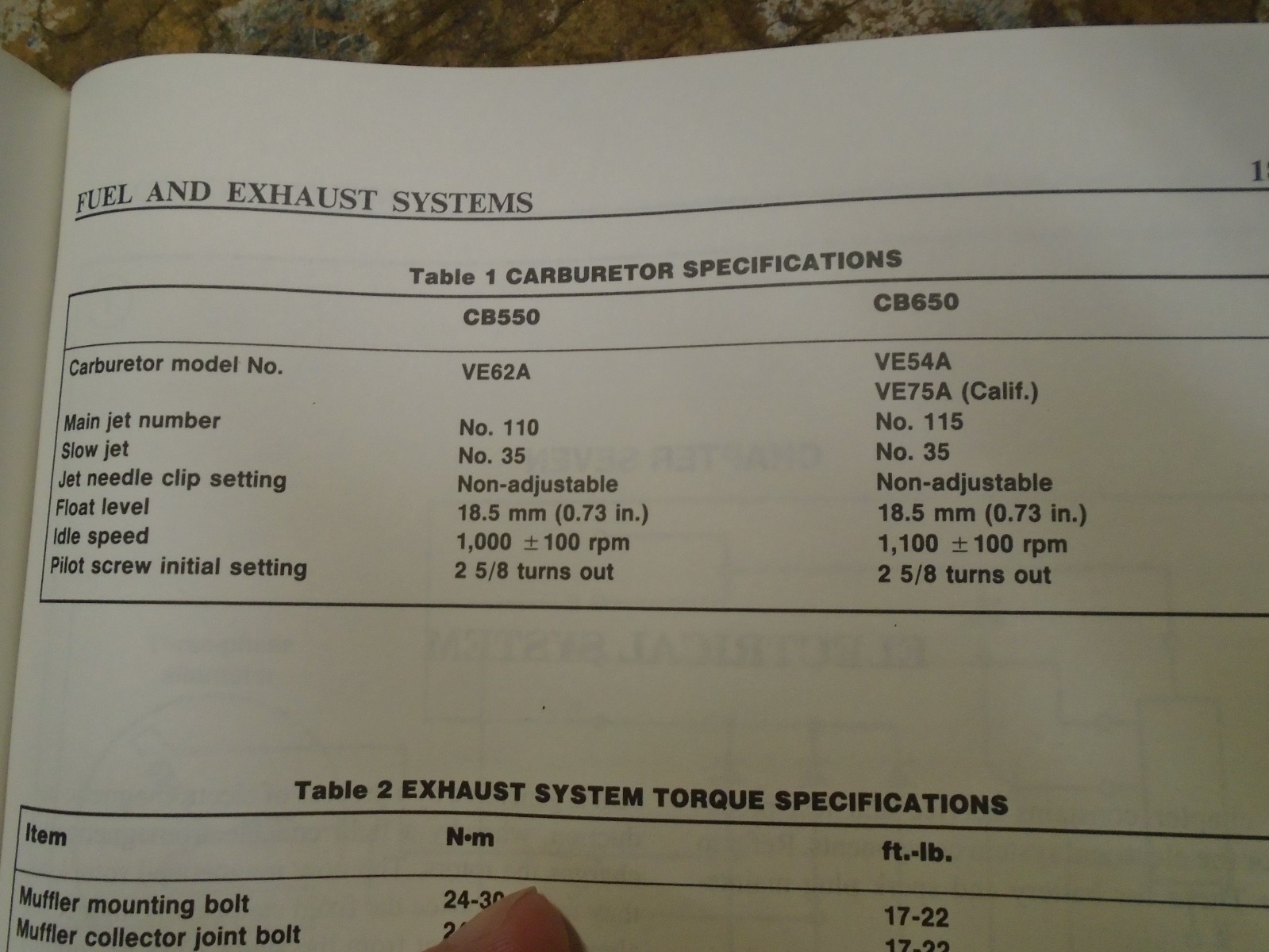

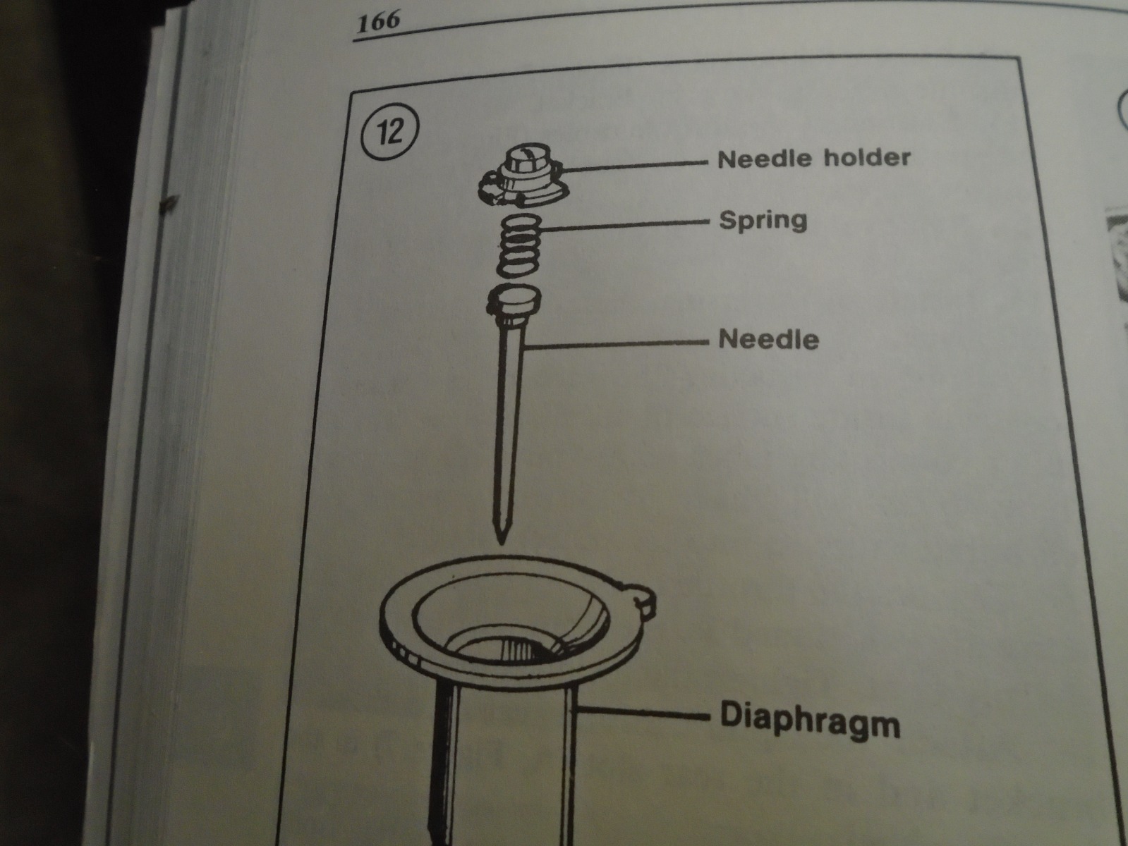

Here's some additional info if it helps! It's from a 550-650 Honda manual. SOO Sorry you're going to have to go the "extra" mile to sort these out but.. Note the "Original" Keihin's had fixed Jet Needles, don't know what those pattern aftermarket ones contain? Often the Chinese versions had unmarked individual jetting bits so you won't have a clue for a baseline. Ganging those two sets together might be a bear. You'll at a minimum will need a 2 into 1 splitter throttle cable to pull up the pulleys.
