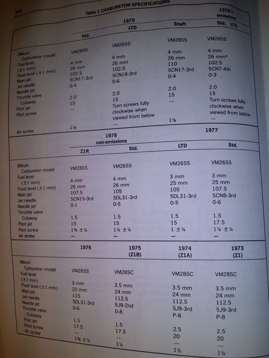

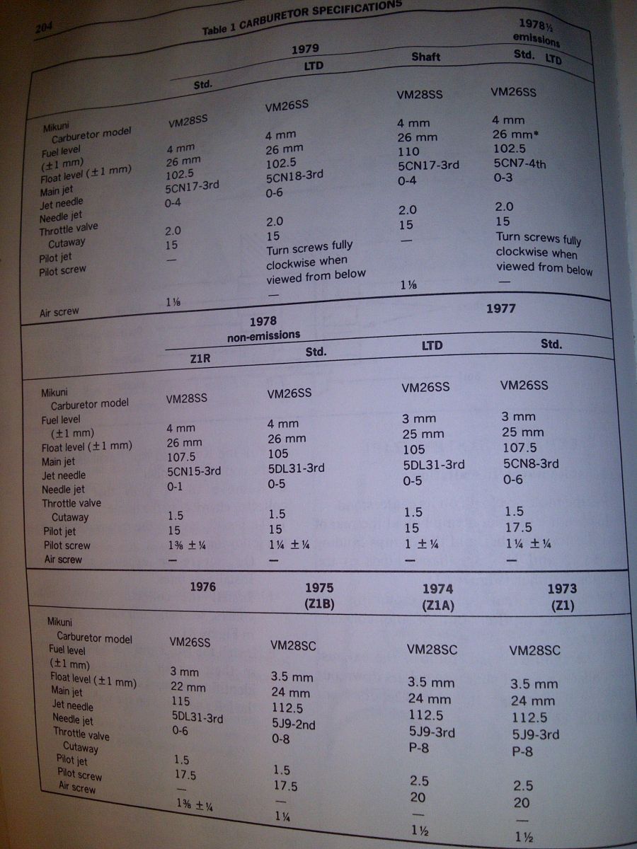

I have some info that indicates the 5cn15 needle was stock on the vm28ss carbs on the 1978 Z1R.

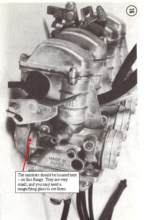

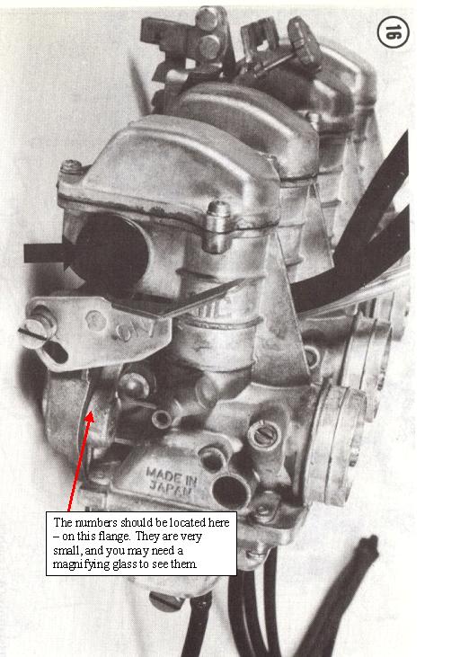

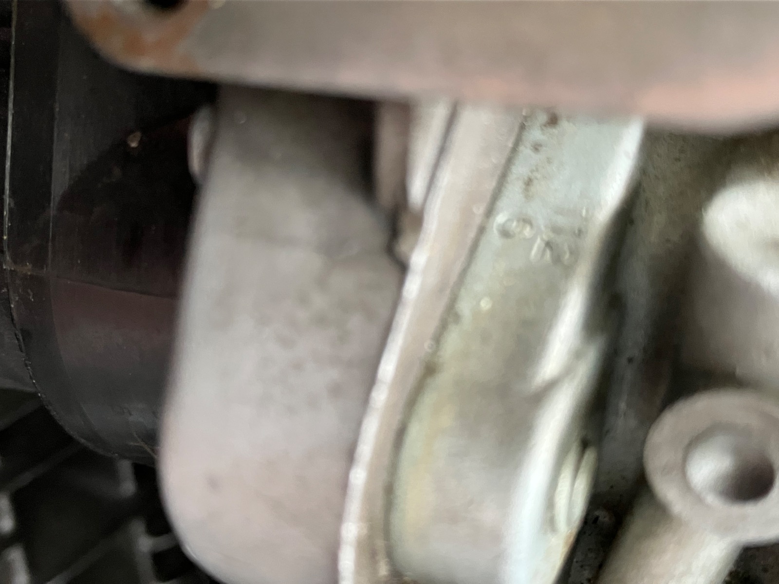

There should be an ID stamped on the carb set either below the choke lever on carb #1 or on the outside of carb #4
If you were to post what the ID is on your set I may be able to provide more info about what they came stock on and what internals were.

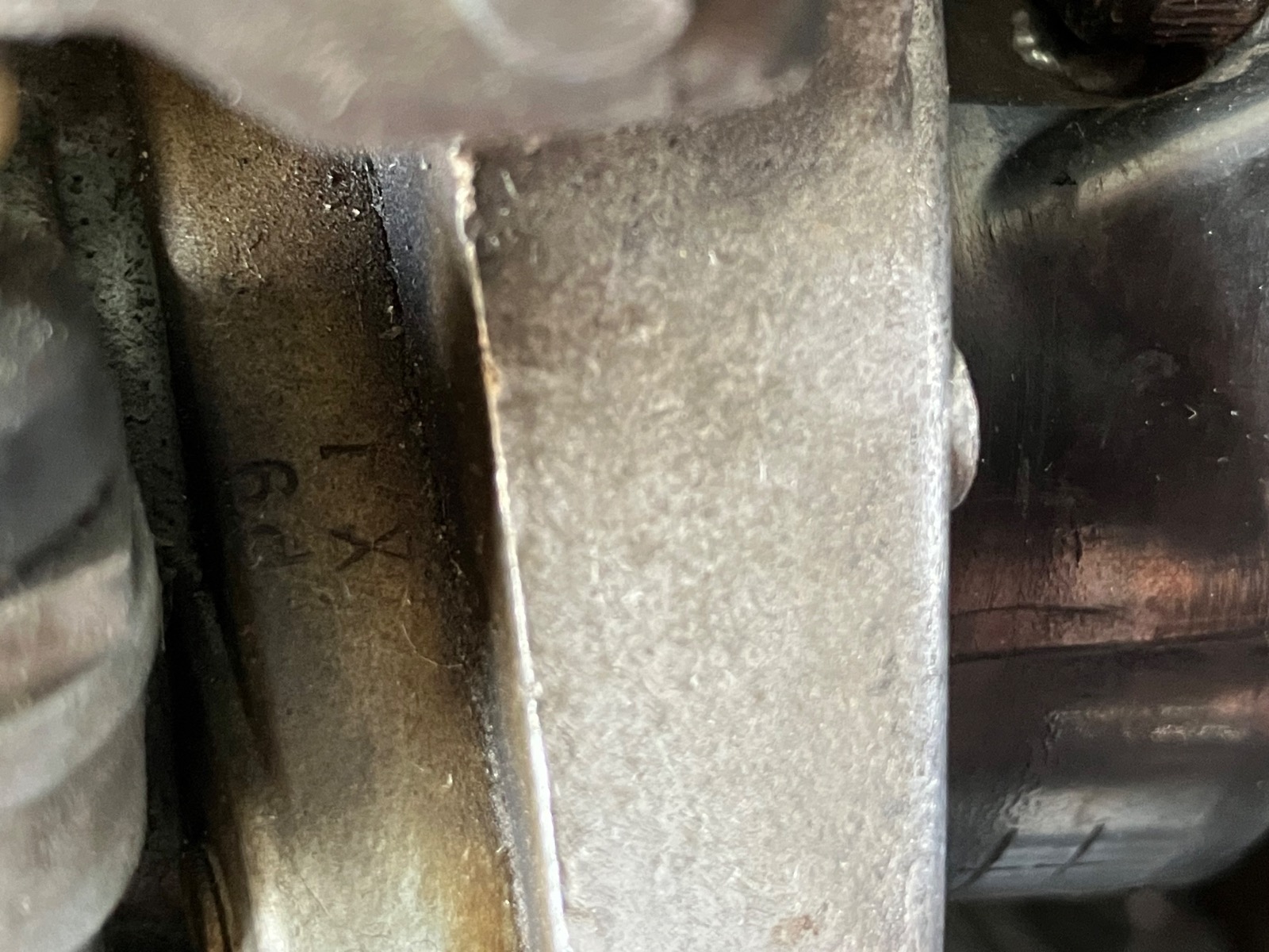

  Thank youu!! Thats weird, I look at your chart and my main was 102.5 and now I put 105 !! The number under the choke is 112-6

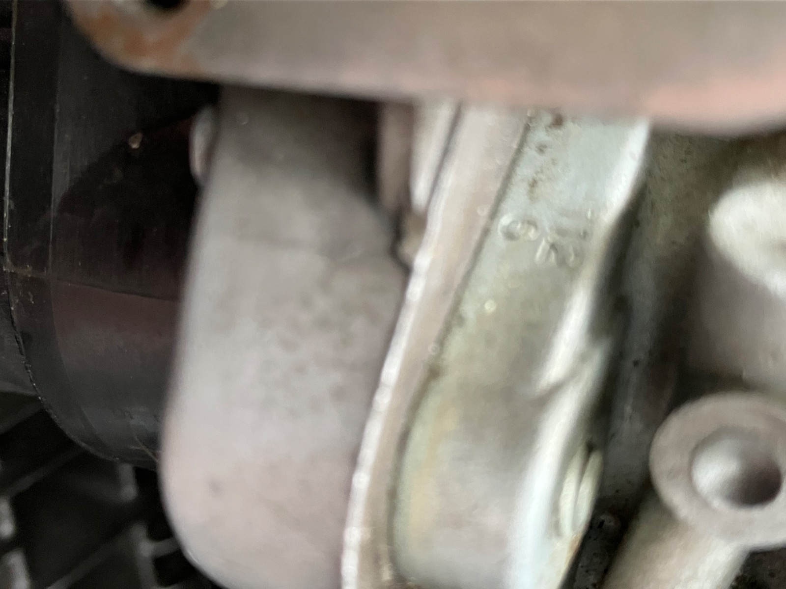

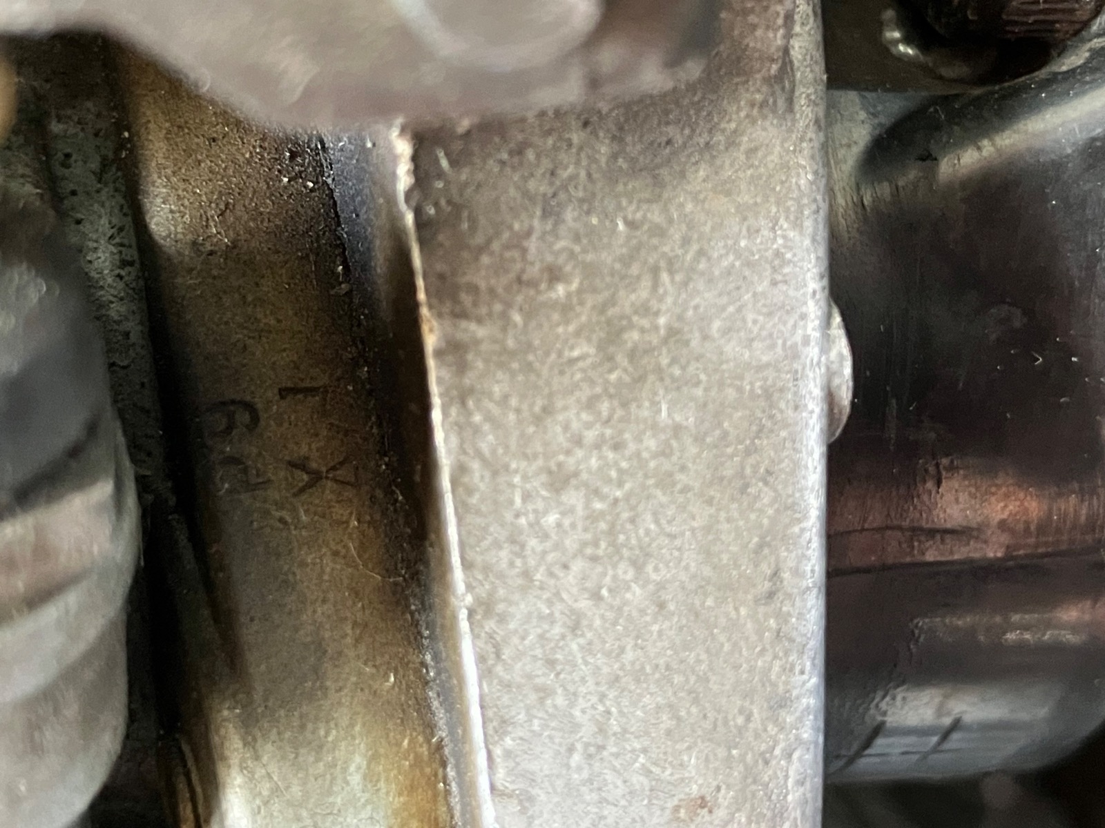

#925110
Carb #4 has that number

Again I have some info that indicates the carb set ID of 1126 was used stock on the 1980 Z1R for Canada It appears it also had the same 5cn15 needle and a needle jet of O 1 just like the 78 version of the Z1R
www.partzilla.com/catalog/kawasaki/motor...or-assy-canada-80-d3
www.partzilla.com/catalog/kawasaki/motor...r-parts-canada-80-d3
