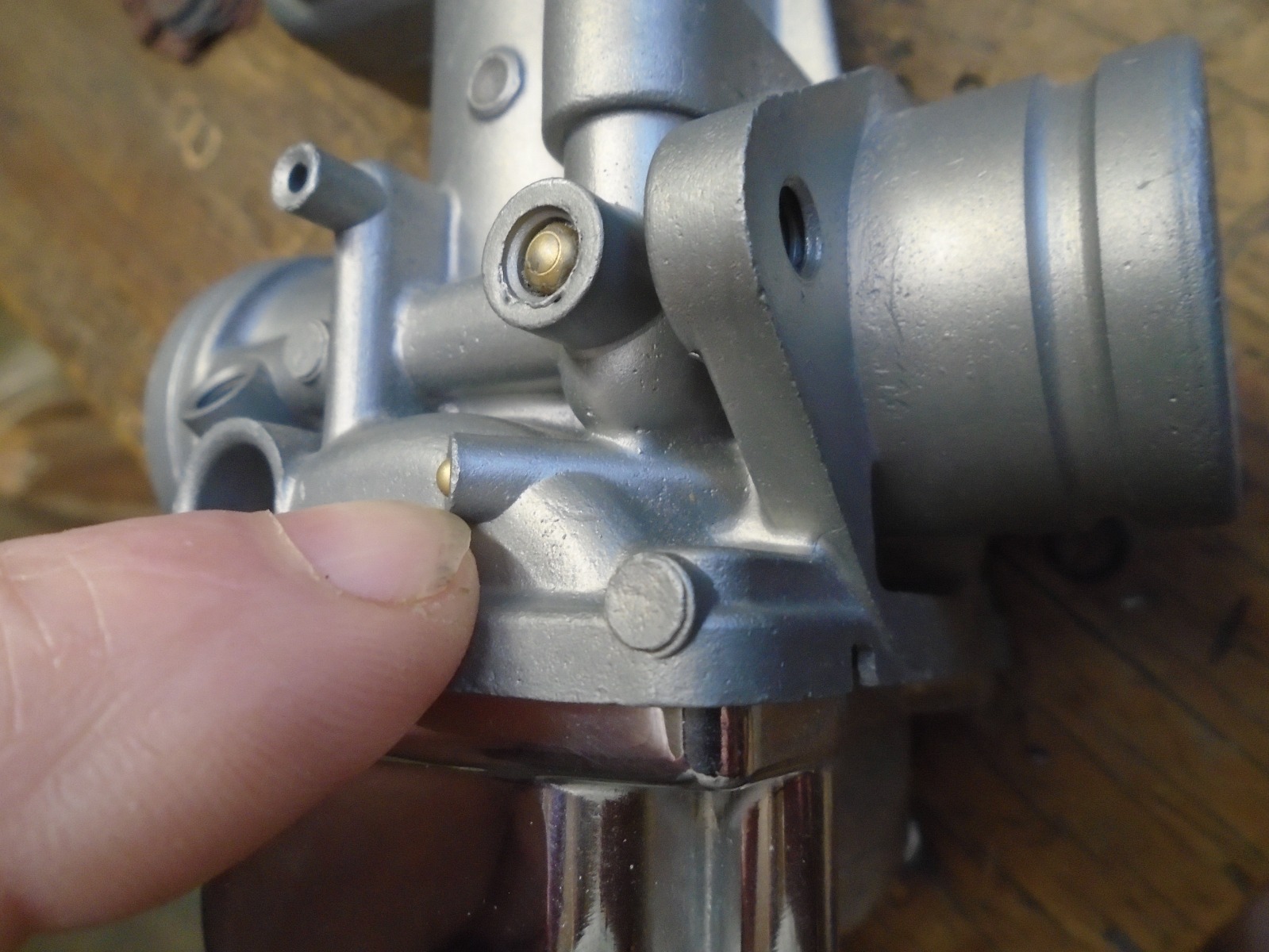

So Im working on my Franken Bike, managed to get a few rides yesterday and today. The question I have is about the choke circuit. The bike is hard to start when stone cold. Yesterday it took multiple tries before if stumbled to life, meaning it was hardly running and it slowly built revs with full choke. I decided to turn in the air screw 1/4 turn in and today it started on the second try but still slowly built up revs with full choke. The carbs have been cleaned and the pickup tubes removed and cleaned inside. All passages have been checked with brake fluid and are clear. A little background on this bike. I purchased a 74 Z1900 and got another chopped up monstrosity with it. Basically I only kept the engine, carbs,and rear wheel. Every thing else was Harley and scrapped. The frame was raked and worthless although I cut off some of the tabs. So I located a 1980 Frame and mounted the engine in this frame. So the engine is KZ900 I believe, I used a KZ1000 crank because I had it and wanted to test it. The carbs are late / early 73/74, the airbox is a stock 1980 Kz1000 box with stock filter. The engine has stock pistons honed with new rings and the head has all new guides, valves with the proper machine work. So why does the bike barely start with full chock and once started takes about a minute before it build revs to only around 2000 with full choke. Carbs have all of the stock jets and new choke plungers and all are lifting off the seat to full height, also carbs have been synced and were almost perfect from bench setting. All the valves have been rechecked and at .005. This is not my first rodeo but Neve have had this issue so any insight will help. I have several sets of carbs and probably will put a set on and see how they react. Before I go to that trouble hopefully someone has an easy answer for me.
I should also add, once the bike warms up it runs and idles well. I can close the choke after a several minutes before I can pull away. It takes about a mile or so before it settles down but coughs a bit during that time. It pulls good from idle and I have just the slightest bog around 4,000 rpm but pretty satisfied on how it runs. Once it is fully warmed up.

Fantastic "left-over" assembly, looks Great! You mention you'd pulled the choke P/U tubes. They can be re-installed too deep if not careful. The casting hole where tube goes connects to a "slightly" angled carb galley. You'll note externally where the singular brass ball is pressed. This galley is longer then needed. From this galley is the hole is milled for choke plunger needle. Being the "angled" galley is longer then needed there remains a "pocket" towards that singular brass ball where DEBRIS can linger and hinder the siphoning from bowl choke jet. Another thing that can happen is when reinstalling the tube you can smash over the hole in insert of tube. Or if using a dirty drift/tool, you can jam crap in that little hole. Reducing flow or hindering it. It's small hole, fractional approx #70 bit size.If when warm, does choke operation affect operation? Because these carbs are the most funky to work on are you sure the slides are shut at idle? Slides initially set too high you won't create enough vacuum to pull from the choke circuitry. Your Colortune will also verify operation. You'll get it!!

Today I changed out the bodies since I had a set, but I don't think that was the issue . After all the work I Hate to admit it but I think It was the fingers lifting the choke plungers. Now I have done many of these carbs and i'm wondering how I may have missed that little detail. Anyway tomorrow I will finish up adjusting those fingers and try things out with the spare bodies. Hope it solves the issue because I hate installing those carbs on that bike. The early 900's were way easier.
