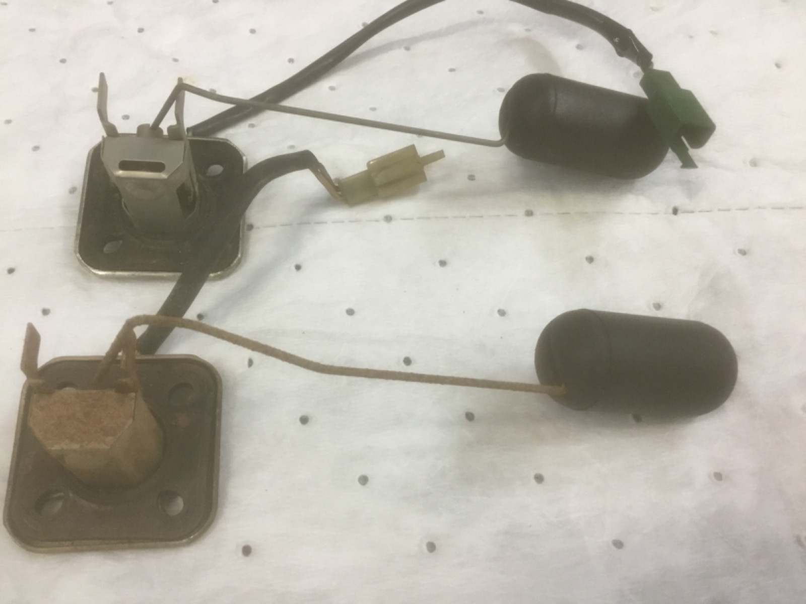

          Just in case anyone else needs a replacement fuel level sensor for their ZN1100 project…..the sensor from a 2008-2012 Ninja 250 only need a minor modification to the float arm to work.   The rusty pic is an original sensor, the shiny one is the modified Ninja 250.   They’re still available new, used on eBay.  [attachment=180919]IMG_
