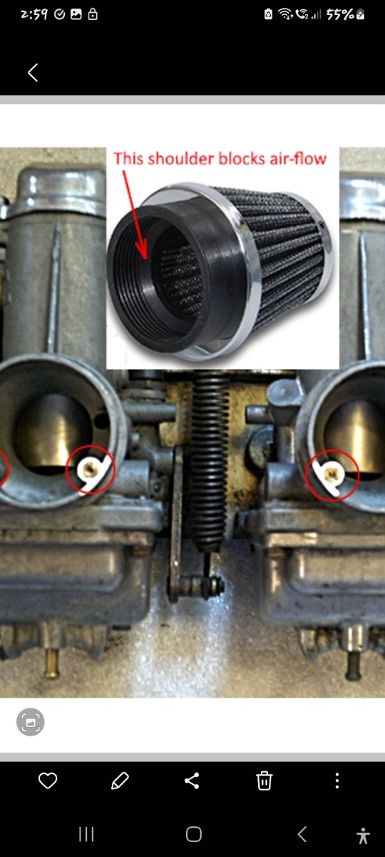

Because you are using k&n's there is a bogging at around 3k rpm.
Air corrector jets resolve that bogging.
They need to be fitted in the intake port on the opposite side to the airscrews. One in each carb.
Circled in red here.
The only other thing that could cause the issues you are experiencing is if the ignition auto advance is not operating correctly. Can you see the ignition advance using a strobe.?

Ah yeah those are definitely not installed. Where does one buy those? I haven't had any luck searching.
