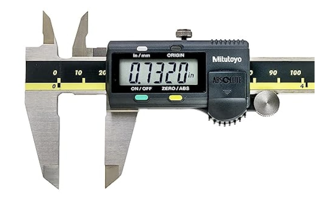

Does anyone know the width of the slot?
Thank you!

10 Jun 2025 11:32
- Posts: 8206
- Thanks: 3577
Re: C clips o rings vendors vm26 kz1000 1977
10 Jun 2025 11:38
