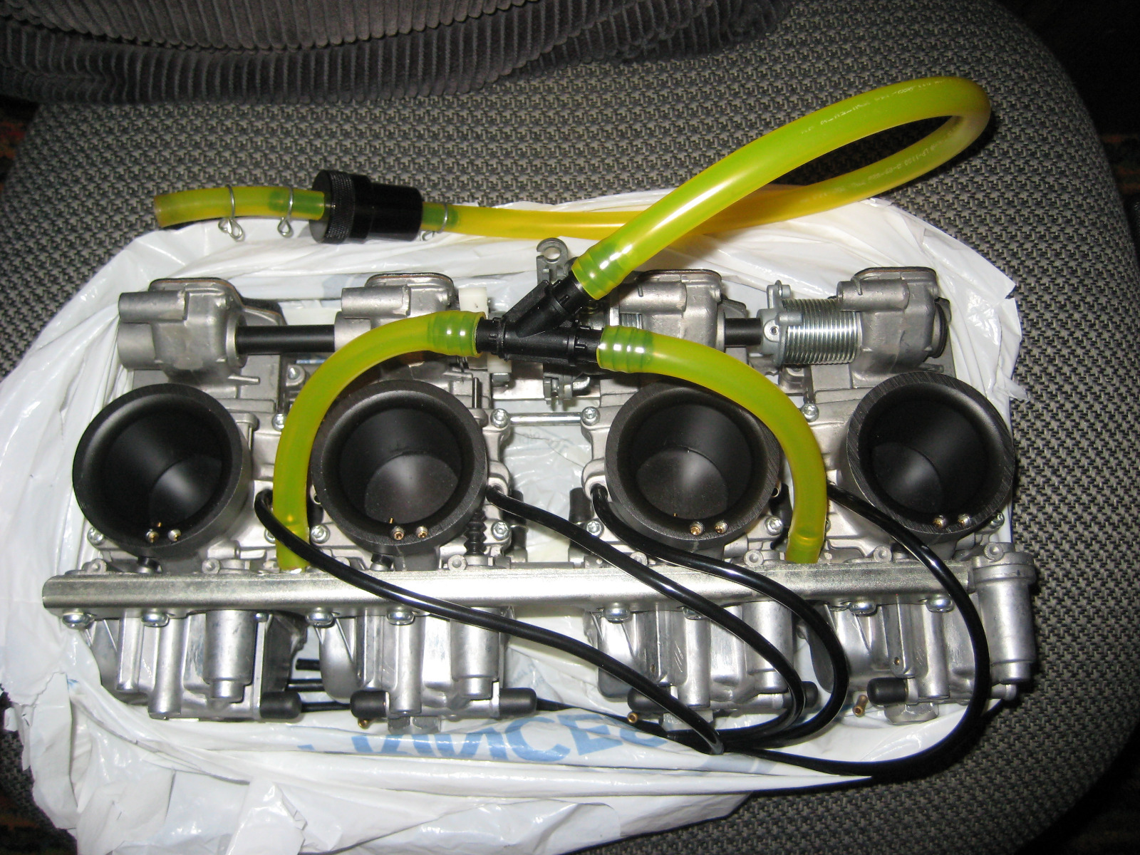

A single outlet Pingel with 5/16" ID lines, Emgo sintered brass filter, and "Y" fitting is what I am using for my 1200 street engine (VM33 Smooth bores) I am shooting for 115-120 HP at the wheel.
My 1327 drag engine (16:1 comp) is using a dual outlet with 5/16" lines to feed 40mm Lectrons. Most guys run RS40's on 1327 to 1428 for street engines, 38's if you have a small valve head (37/31) I am running 40 Lectrons because that's all I could find used at the time, waited for 4 years for some 38's that never appeared. That engine is pretty tame so maybe 140-145 HP to a 7" slick.
I have some RS34's and the fuel tees fit 5/16" line, those tees only have one part number in the Mikuni catalog so even RS40's use a 5/16" line, the tee ID is probably 1/4" (never measured it)
The internal fuel passages are the limiting factor for fuel flow, that and the needle valve assembly size. I have never see a fuel flow consumption chart at WOT as I don't think too many motorcycle engine builders are worried about it.
If I was running a 1327-1428cc street engine with RS40's I would run a dual outlet Pingel with a filter on each line feeding the carbs. With two lines you should never run out of fuel flow.
