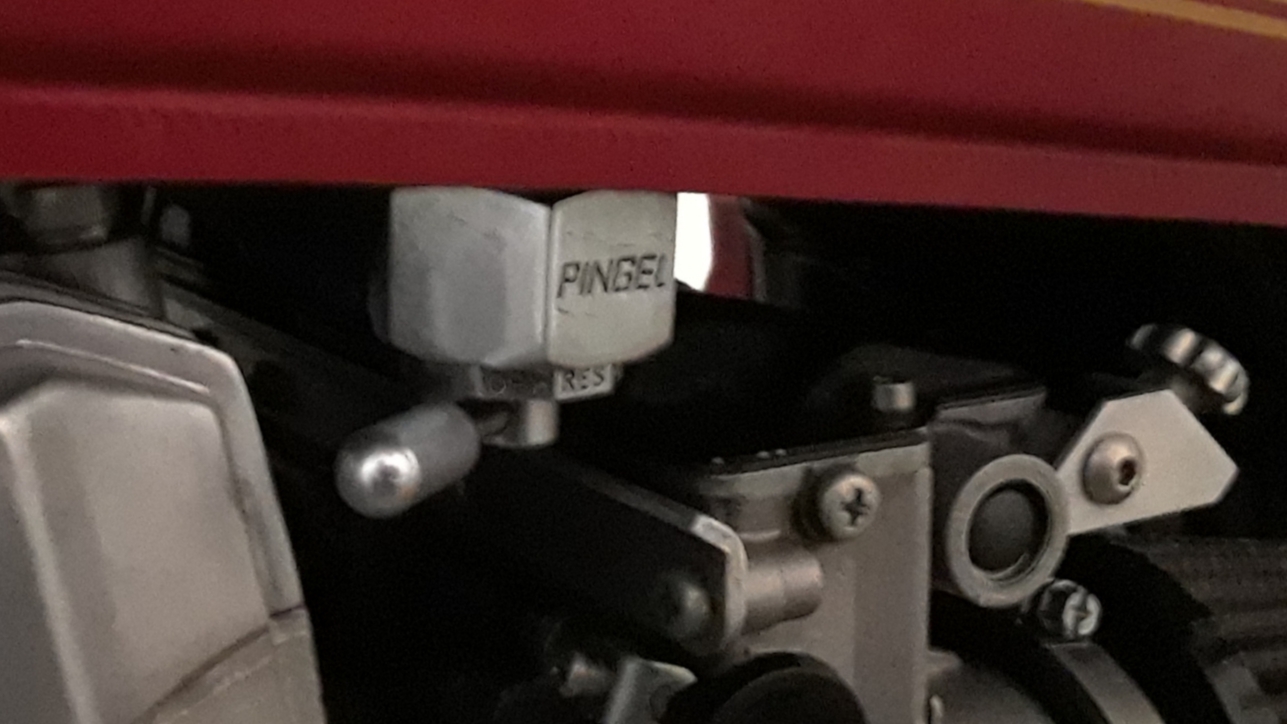

I dont know about you guys but it's frustrating to buy these reproductions and have them leak. I normally use the Pingle single outlet petcock along with the Pingle filter with a one in and two outlets for the 4 cylinder bikes. Well I decided to try the greatly improved units for my last bike and sure enough it leaks. Granted not a lot but I had my tank off overnight and there is a puddle that formed underneath the tank. If the bike is stored during the winter it may overflow. I have had great luck with the Pingle products so one is on its way to replace to greatly improved one.

If you have a modified bike Pingel is the go to brand name.
As far as other aftermarket petcocks I would only buy one that is "made in Japan", usually cast on it. The Tour Max brand that Z1 ent. sold was such a part, but that was a while ago.
Other than that I believe Kawasaki still sells the petcock for the Police 1000's, a bit pricey but at least you can get replacement seals (Only vacuum type available)

Ya,I agree with the pingle. Never failed me.

31 Mar 2025 07:28 - 31 Mar 2025 07:49Seen that issue and sometimes it can be fixed with a little spray of silicone lube. If that does not fix it while on the tank you may have to drain it and remove the valve to flush it properly, like anything that contacts gasoline tarnish can build up over time. Like any mechanical part they do require periodic maintenance.SWest post=910742 userid=43940The problem I've had with them is they get so tight you can't turn the lever.
I have had one apart, there is a molded Delrin plastic slug inside that seals off on a SS ball. That plastic slug split in half which caused it to leak like crazy, the only time I have seen one fail.

31 Mar 2025 07:31 - 31 Mar 2025 07:41On the Pingel web site the base price is $120 then you need to ad a adapter which could be between $35-45 depending on what tank you have. Then add shipping and tax. Yes I agree they have gotten expensive but they are worth it.What do you guys pay in the US for these (over $200 here in the UK)
I have bought good used ones on Ebay a few times, or at local motorcycle breakers where you can haggle a bit. I have 4 of them and only one was bought new (back in 1985)

There is no adapter for the Z1/Kz bikes. You use the 22mm HD unit. if you have a Suzuki or Yamaha that the petcock get bolted to then you need the adapter and go with the 1/4 pipe thread unit.
