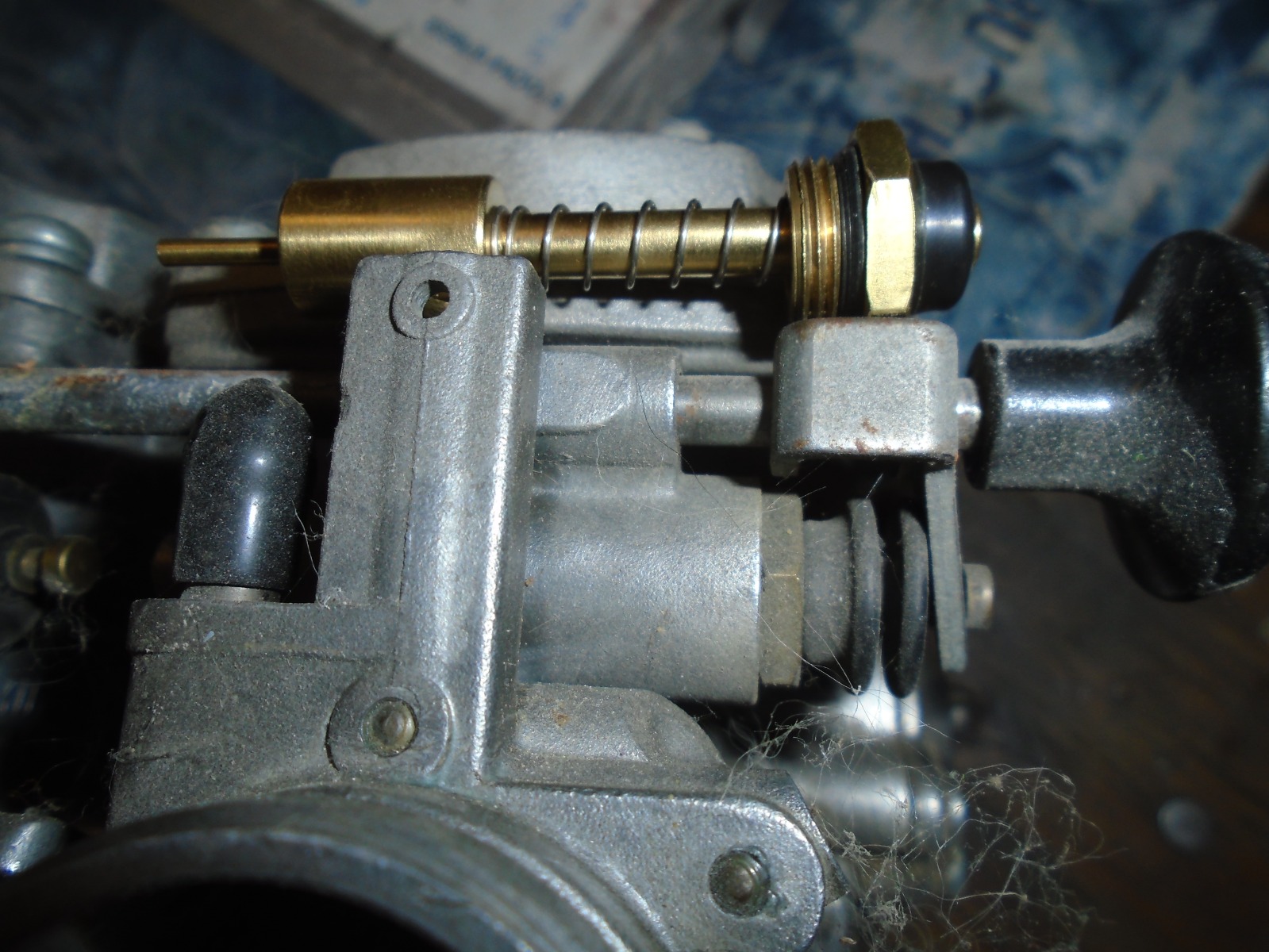

For Your consideration Cartal. These BS34's by design can be prone to "over fueling choke" issues. They don't utilize a conventional spring to push the plunger back down, Suzuki did. You'll note the accordion bellows on your set. They instead use the choke rod lifters with springs on the rod inside the lifters and a circlip to index them. The fork in the lifter piece pushes down on the plunger. You Have to set-up this choke rod and bits correctly!! Note in picture of what Your set is and what a BS34 Suzuki loose plunger look like. Just something to think-about and double check..
