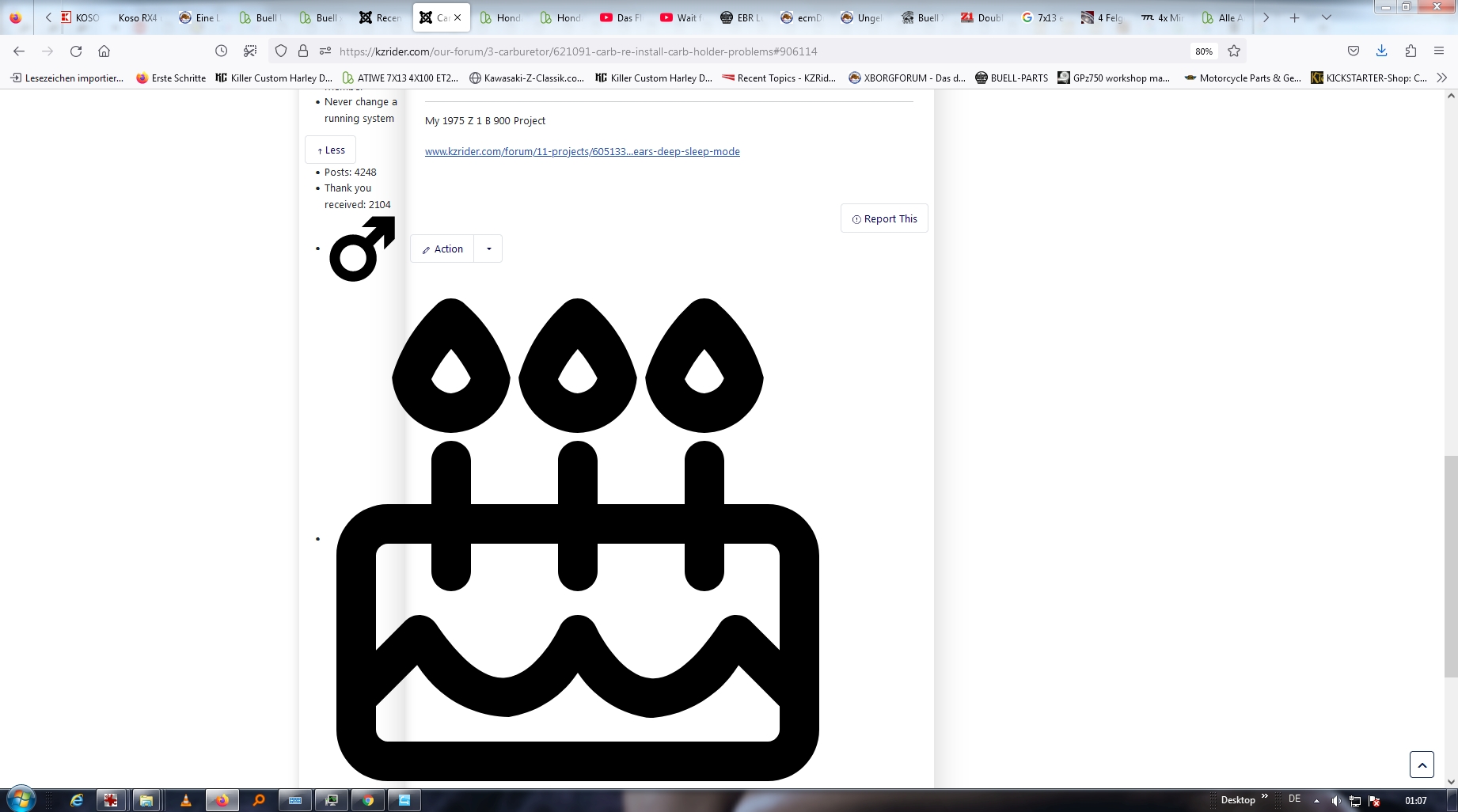

17 Nov 2024 00:13I believe it's a "glitch" one of the symbols on my profile did the same last week but as with yours (as far as I can see) it went back to normal again which is good as you would need "vielen Kaffee" for that much cakeHm, Wookie is this big birthday cake a browser bug or a board software improvment update?
