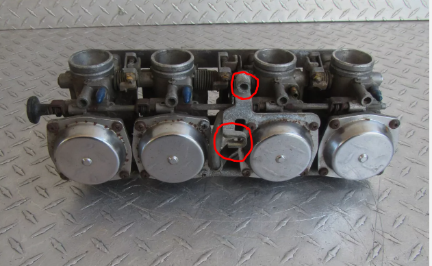

The way they're fitted the cables go on a sharp angle to the pullies. Tried other ways but no soap.

You would need both the bracket and the pulley, which attaches to one of the throttle shafts. It wouldn't surprise me if the throttle shaft is different too.
