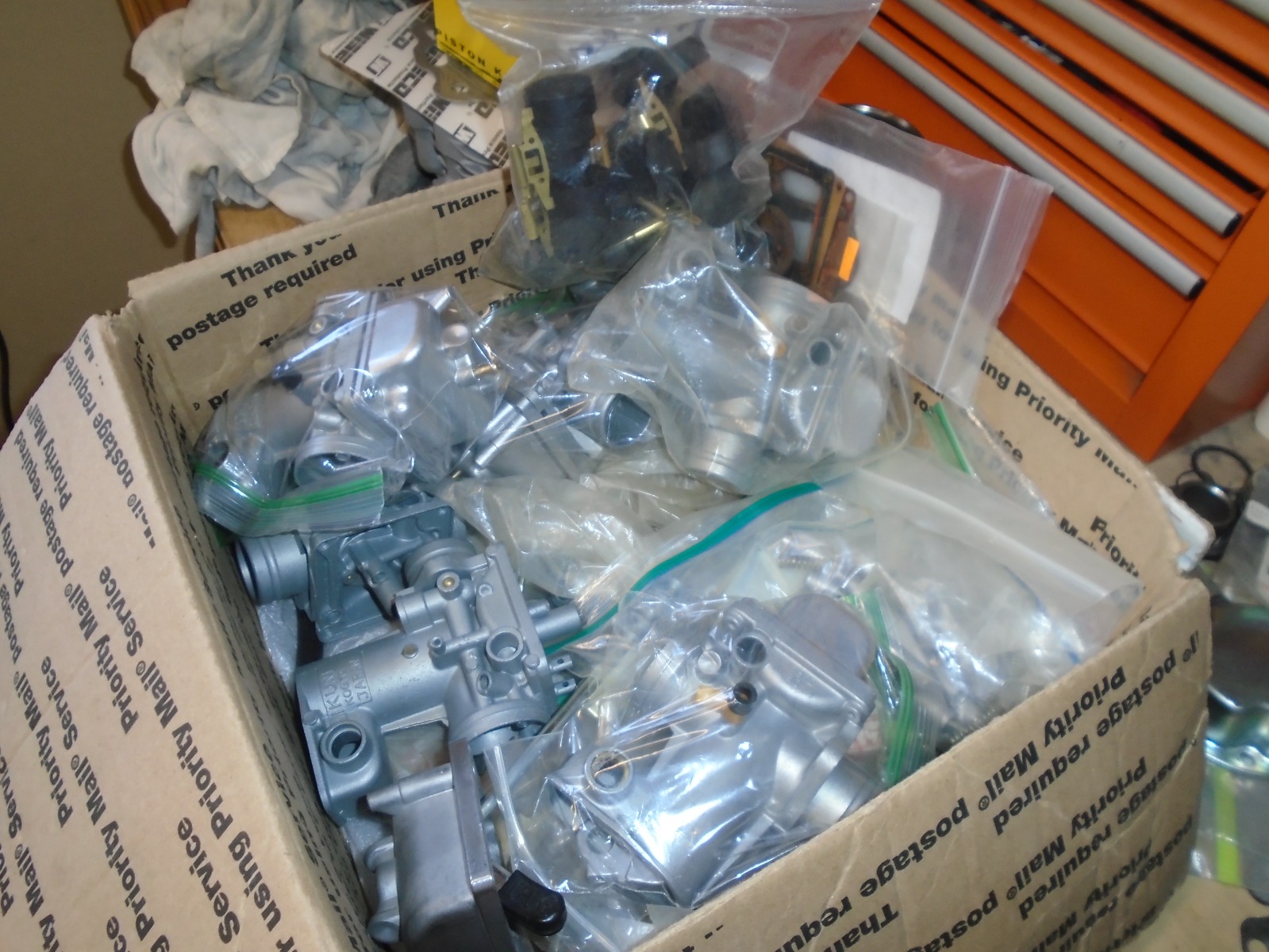

At the risk of starting yet another "oil discussion" -
I'm ready to assemble my VM28's after a thorough cleaning, what is a good lubricant for the moving parts and pivot points?
