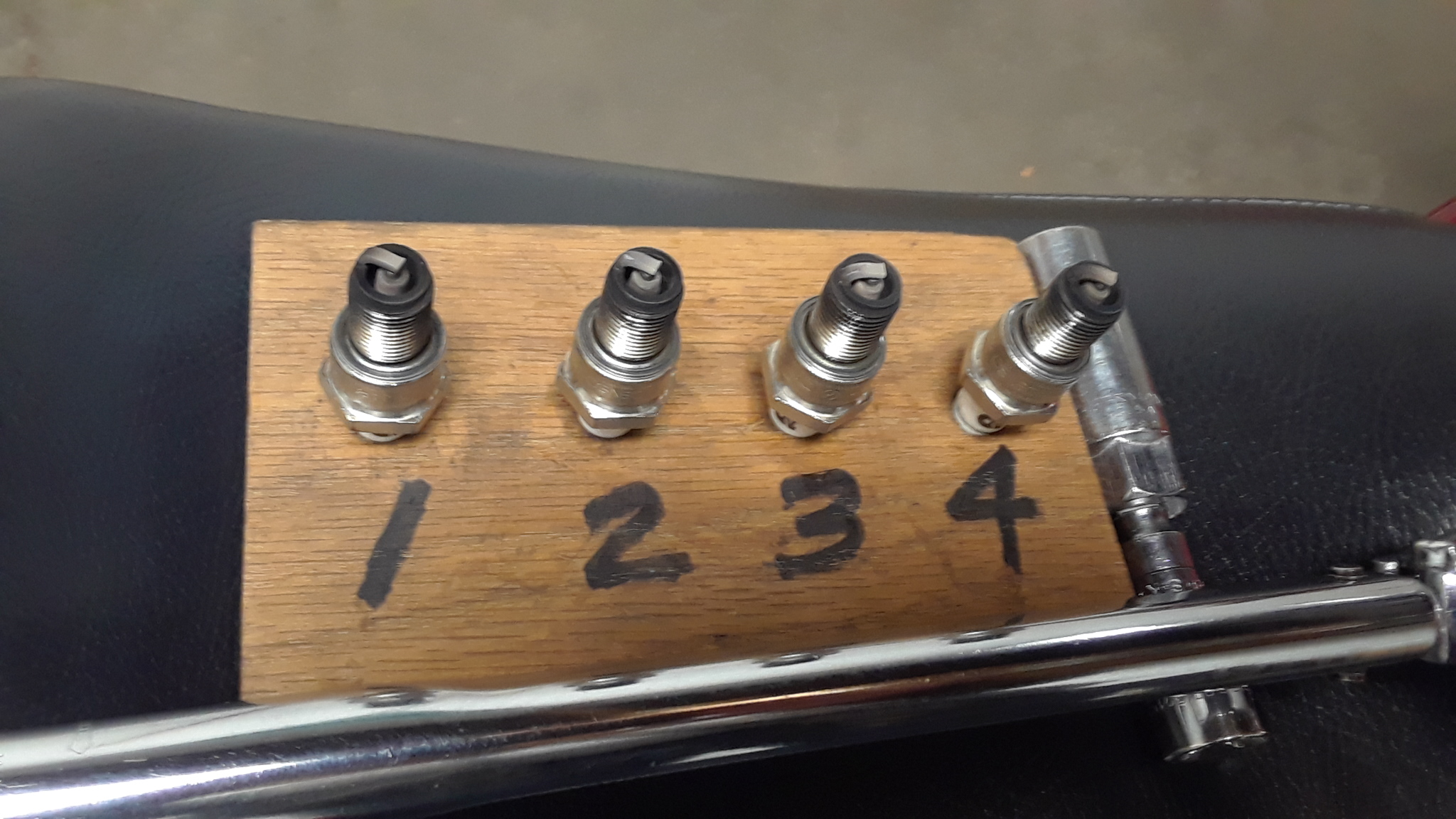

With current cool air temps and low humidity where I live, my engine purrs at idle, and spark plug color appears good. Acceleration and deceleration are strong/smooth with the following (air corrector?) jets installed:
#1Â size 1.0
#2Â Â Â "Â Â Â 1.2
#3Â Â Â "Â Â Â 1.2
#4Â Â Â "Â Â Â 1.1
The Pilot Fuel Screws are set between 1/8 and 1/4 turns out from lightly seated.
