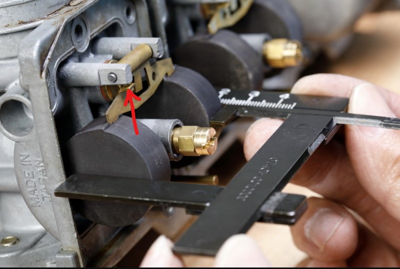

- Posts: 7906
- Thanks: 3279
Re: Carb Floats Hang Down Uneven
02 Apr 2023 16:42 - 02 Apr 2023 16:44
Last edit: 02 Apr 2023 16:44 by Nessism.

02 Apr 2023 16:54My understanding has always been that the tang determines this. In any case, no worries. My carbs are sorted and functioning properly
- Posts: 4836
- Thanks: 1851
02 Apr 2023 18:54Correct. That’s the maximum down travel tang I referenced. Thanks for the picture.
