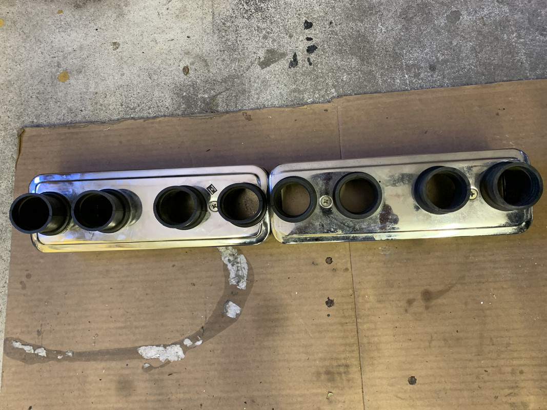

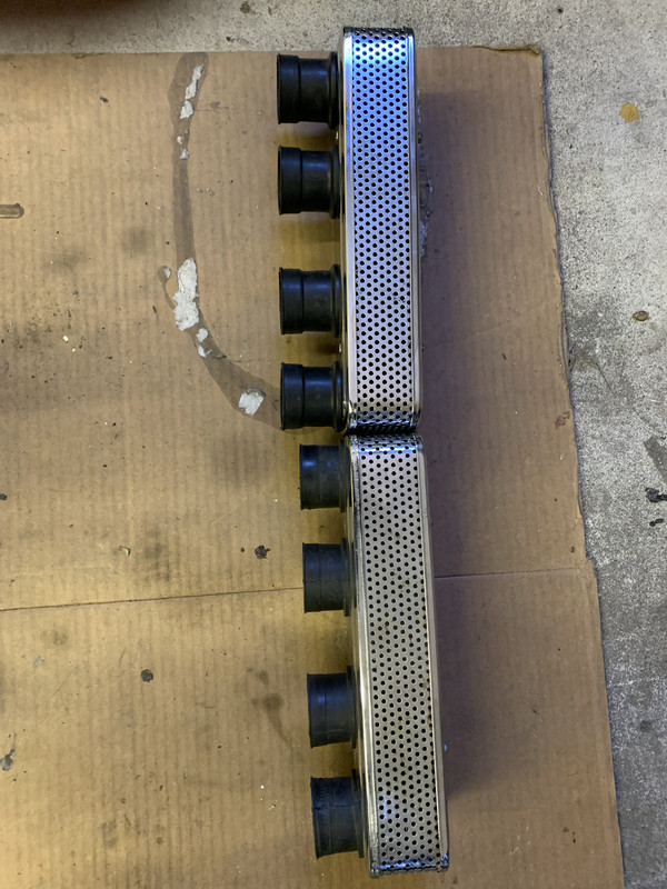

Thanks ronniev, I thought I'd show you why it doesn't fit. In the first pic you can see the mounting boots are about a 1/2" longer than the other filter that I removed from my LTD, and in the second pic the filter I got from you is on the left if you look closely you can see the boots are are in the center of the filter but on the filter I have the boots are about 3/8" higher. This causes the filter to hit the frame and will also interfere with the petcock.
This may fit an early Suzuki but I'm not sure but I do know it won't fit a Z1/KZ. I just got back into town and I'll ship this back to you very soon.
