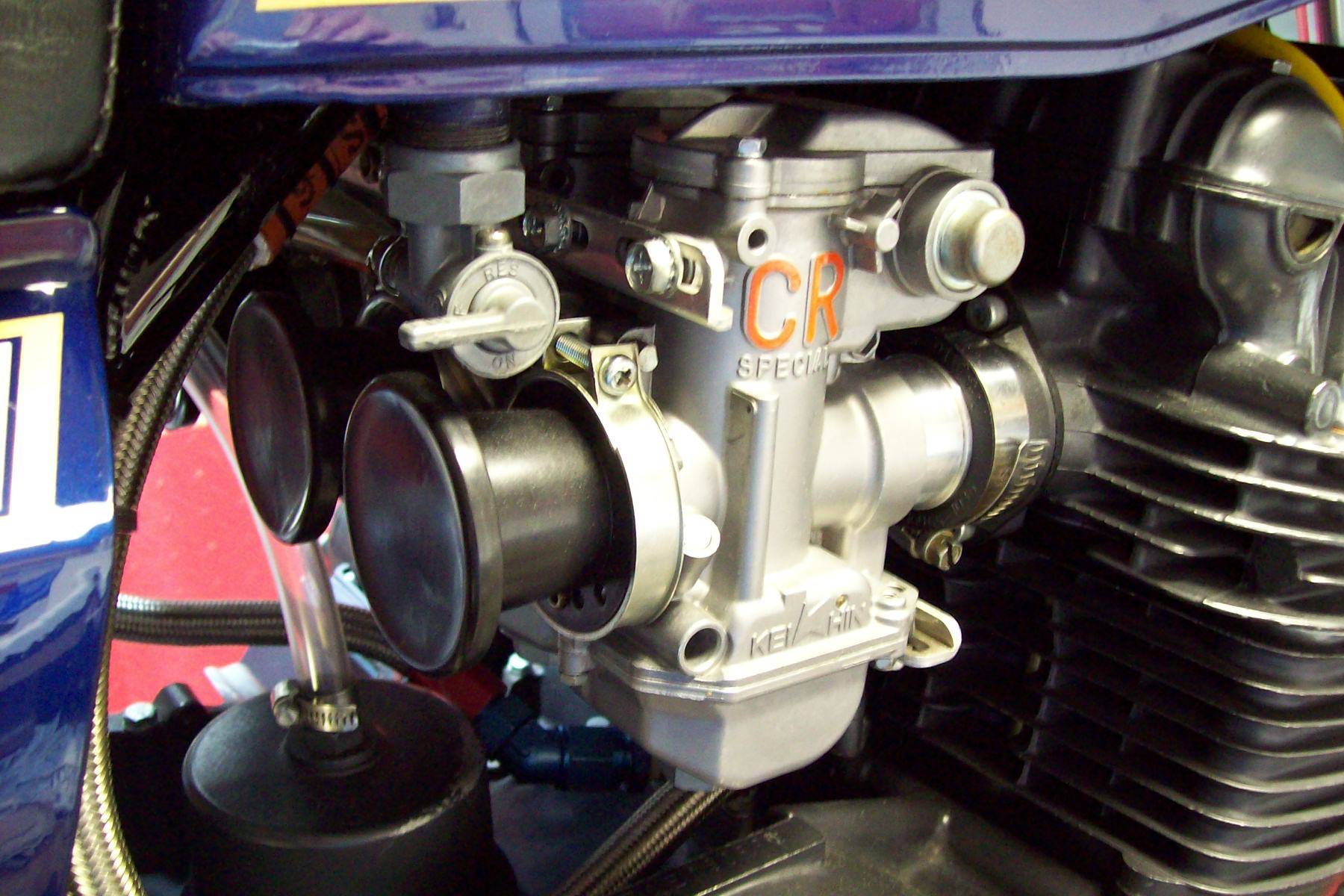

hello all ....so, I have had the CR Special smoothbores rack-of-4 on my 650 since the mid 80s (see pic), and thru regular maintenance, cleaning & adjustments, they have served my Kaw very well, never any major issues or problems, except this one: on occasion, on long backroad rides with lots of high Rs and cruising 65 to 70 MPH, one of the 4 carbs will begin leaking fuel "at idle only", never more than one carb at a time and never the entire rack of 4 carbs (it did it on my ride yesterday, first #2 carb, then stopped, then # 3 carb, then stopped) ....I usually take back off opening the throttle way up, shifting thru the gears at high rpms and "something" clears or resets and the leak stops when I come back down to idle at stop after a little cruising ....2 years or so ago I completely disassembled not only the entire rack, but each carb individually, did an ultrasound cleaning, cleaned and/or replaced all stages of jets, checked for float level & stop, etc, etc ....bike starts, runs, idles and pulls great ....has for years (64,585 original miles) but highly modified .....I mean I know it could be a speck of dirt or whatever I did not get helping the float for the leaking carb to stick ....but man oh man the internals on these carbs are clean ....to note: interior fuel tank filter, the tall one just above petcock inside, there and clean but I am not running a filter on the fuel feed line from petcock to carbs ....lastly, I run high octane in the bike, could it be something in the brand of gas I'm using ? primarily Shell #1 and 76 #2.....all insight & assist appreciated, thanks

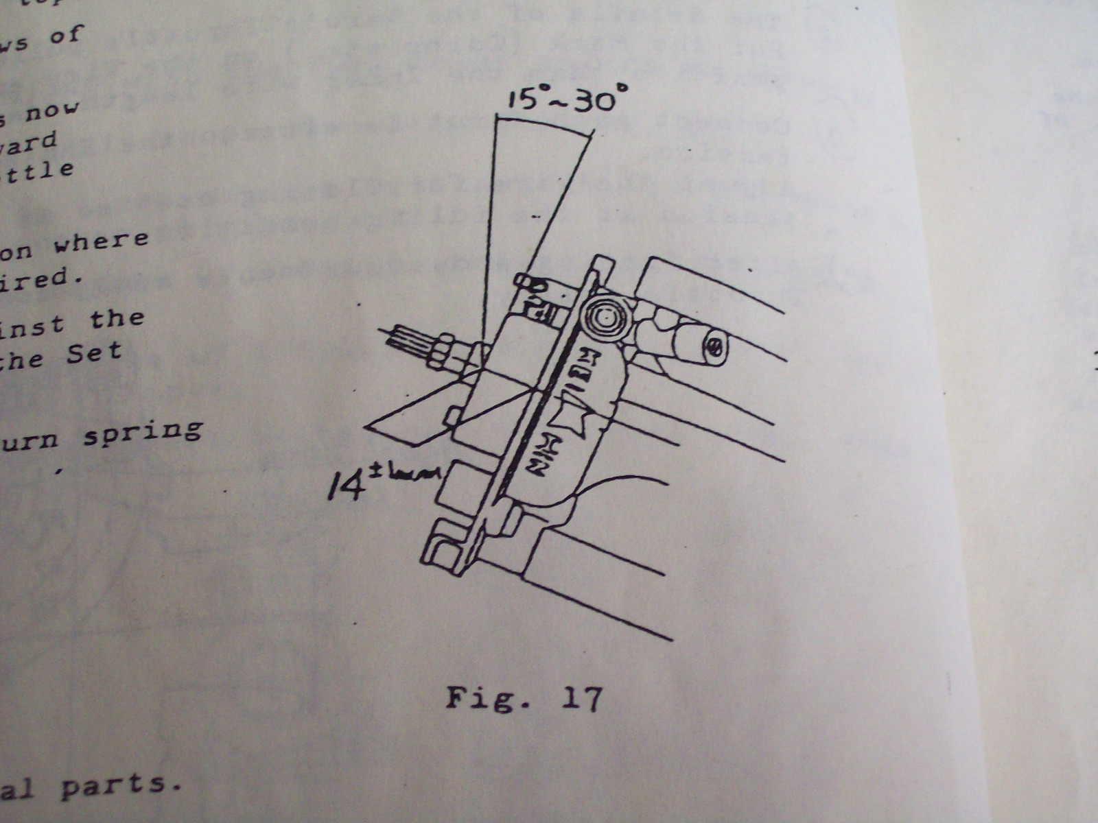

#35 is the o-ring you want. Keihin part number is 16075-MBO-0030. Sudco number is 018-694. Sudco is the Master Distributor for Keihin parts in the U.S. They always had my parts in stock over the years. Here is how you are suppose to check float height right out of the factory Keihin CR manual. Make sure you spray the new o-ring and where it fits into the carb body with like WD-40 so you don't hurt the o-ring as you push in the seat.
