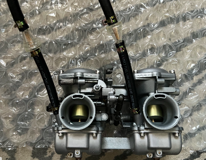

Backstory:1977 Kawa KZ750 Twin B1I keep my petcock on reserveBike was surging and acting funnyOnly ran when, while running, I would turn the petcock to OFF and then RESERVE, otherwise it would dieTook the tank off and then the petcockBefore taking off the petcock, I checked to see if fuel flowed. It did flow out of both petcock ports, but on RESERVE, it only flowed out of one. Cleaned it and the tankA friend and I rebulit the carbs, dipped them, checked every single part of them and replaced what needed replacingNow they look brand spanking new. Will reinstall them and update the forum. Btw Carb boots are all good.

Nice work, they look great

Thanks for your comments, as always. Plunger is fixed too. You were right, the housing was damaged.

Did you sandblast the carbs and brackets? If so, the brackets are going to rust if you don't paint them with something.

01 Sep 2022 17:20Thanks. They were sandblasted and thats a light silver paint you see. its protected.Did you sandblast the carbs and brackets? If so, the brackets are going to rust if you don't paint them with something.

04 Sep 2022 11:32By the way, you were wrong. the first one is right. the second is wrong

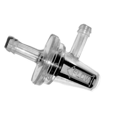

I think Scirocco is right. If you have turned them both the same as the one on the right in your picture then that will definately cause the issue you have in your other thread.
They should have flow direction arrows on them. Flow direction arrow should point from the tank to the carbs.

04 Sep 2022 11:46No, hes wrong. The filters have an arrow on them which shows how the fuel is to meant to flow. From the petcock to the carbs both filters should be like this:I think Scirocco is right. If you have turned them both the same as the one on the right in your picture then that will definately cause the issue you have in the your thread.
fuel tank to fuel line to filter ( | --->) fuel line to carbs.
in my photo the first one is right.
the second photo is the one that shows it in wrong.
Instead it is fuel tank to fuel line to wrong facing filter ( <---| ) to fuel line to carbs. Ive corrected it.

Are you 100% sure? Every tapered inline filter I have ever seen has the wide end as the outlet and narrow as the inlet and if they are in backwards it would cause the issues you are experiencing.
Second pic is k&n and looks identical to yours. Both have flow direction arrows on them of thin to thick.
Just going back through your posts you posted a picture of a gravity tap but I thought the 750b1 has cv carbs with an outlet for a vac tap line. So begs the question of why are you using two inline filters and two fuel lines?
