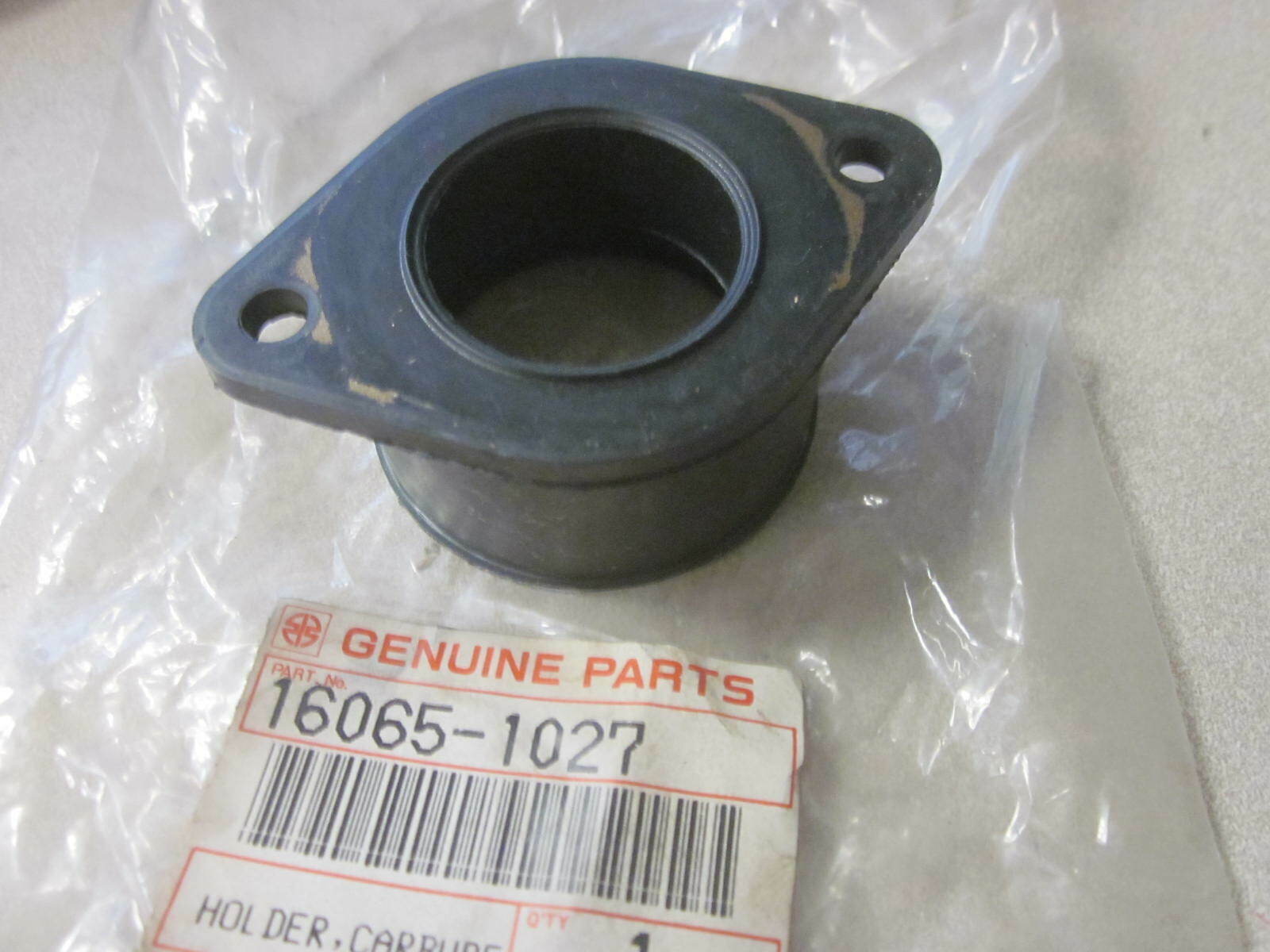

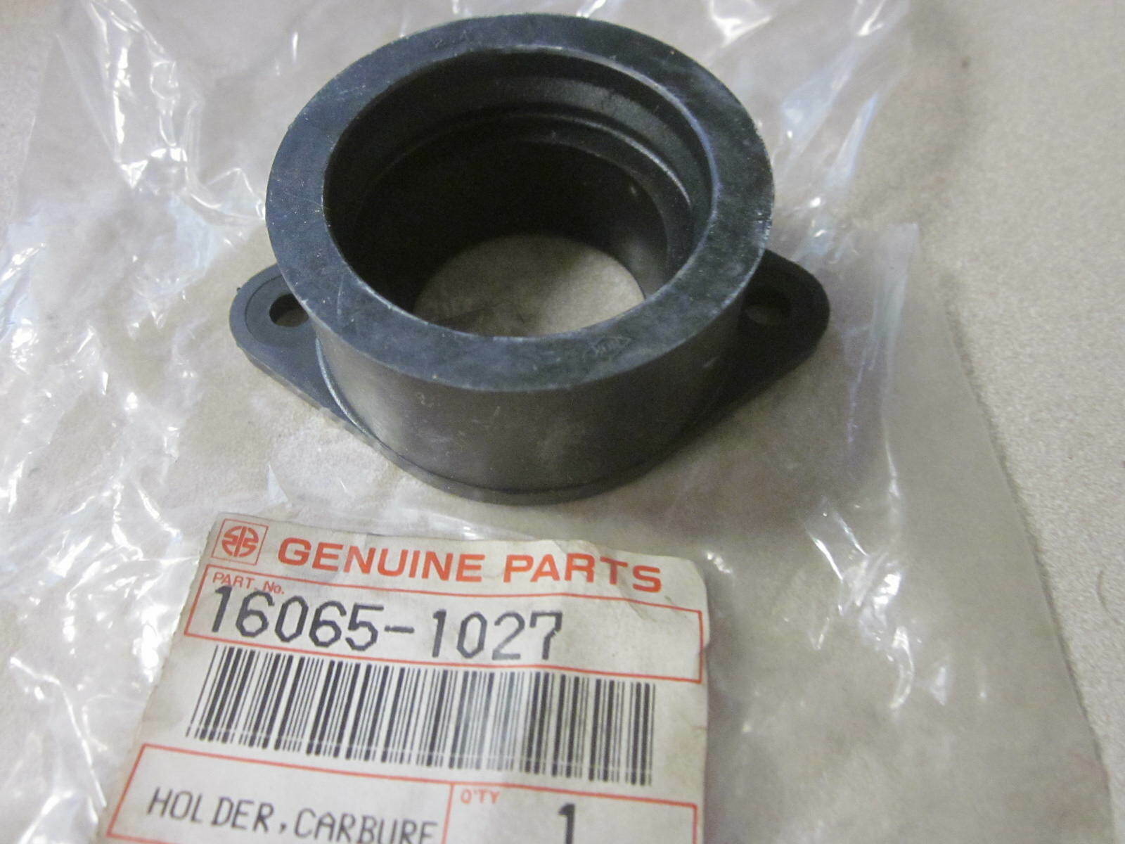

The German Z440 model engines are power limited to 27 HP. The german model rubber intake boots (16065-1002) are air flow resticted by narrow the passage port between the carburator and cylinder head port. The off limit HP boots part # is 16065-1027.

Hi Texas kz and scirocco for reply and sorry for my delay.
Ibought tthis part number and not fit in my carbs, those are more big.
Mine are Keihin CV32...

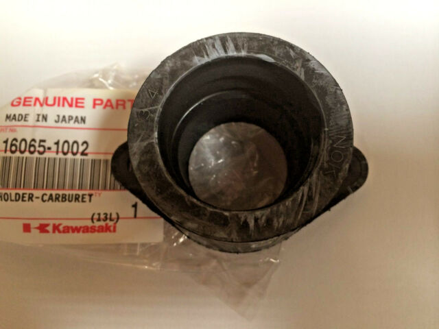

Hi Texas
you right, the intake boot for my carbs are 16065-1002, I have doubt about the horse power. This bike was sold in Argentine and not Germany.. and Kawasaki just export bikes with this carbs only to Germany
