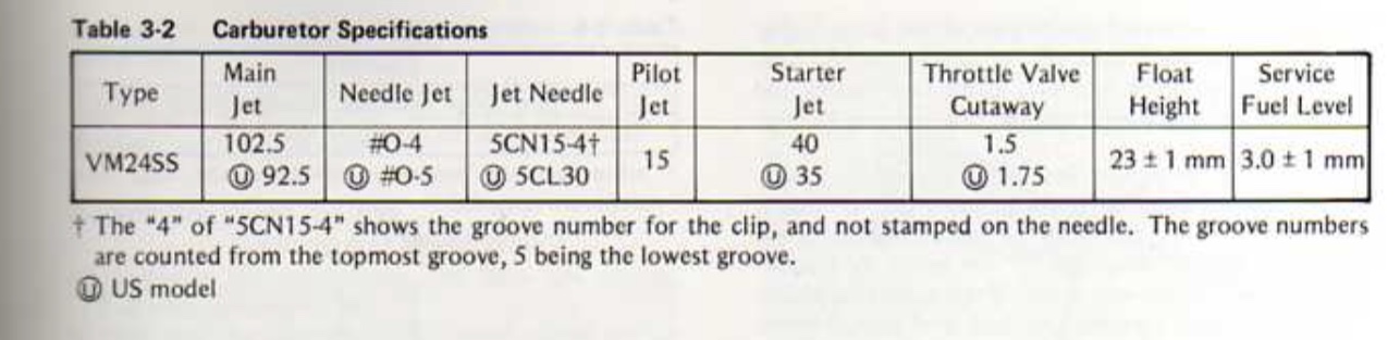

So I should go back to pilot 15, and stay with 112,5 main?
I understand 102 is stock (650) so going to 112,5 its a increase of 10,5 for going from 650 to 810 and 4to1 exhaust.

As mentioned previously Gordone, You should retain all the carbs stock settings as a baseline and start with only increasing the main jet as you have for the larger capacity .
Once you are satisfied with the top end fueling you should work down.
Any slight changes needed to richen the pilot mix should be able to be covered by adjustment on the air screw.

So I will go to stock pilot 15, I need to order 4 15 jets.
From reading what you saying, it looks likte it`s a big posbility that the main jets is to big.... undersood correct?
I have spare main jets in size 120, 117,5 and 115...
So what I wanted to ask about, then when I first have to import jets from US, its way cheaper also order main jets at the same time.....
Stock: 102
Right now: 112,5
So the questions is what main jet sizes should I purchase to be covered in the tuning in the spring ?
Stock: 102
Right now: 112,5

I would say that those 112.5s to 115 are around where you need to be.
I would buy some 110s but i think you are pretty much covered with what you have and you may not need them.
Every set up is different and until you actually run the bike it's just an educated guessing game.
Just be sure to start a little large on the main and work down.
