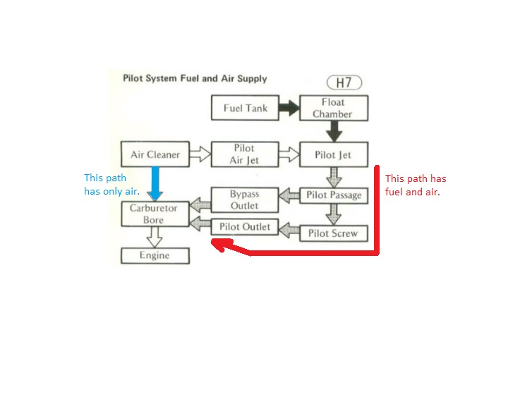

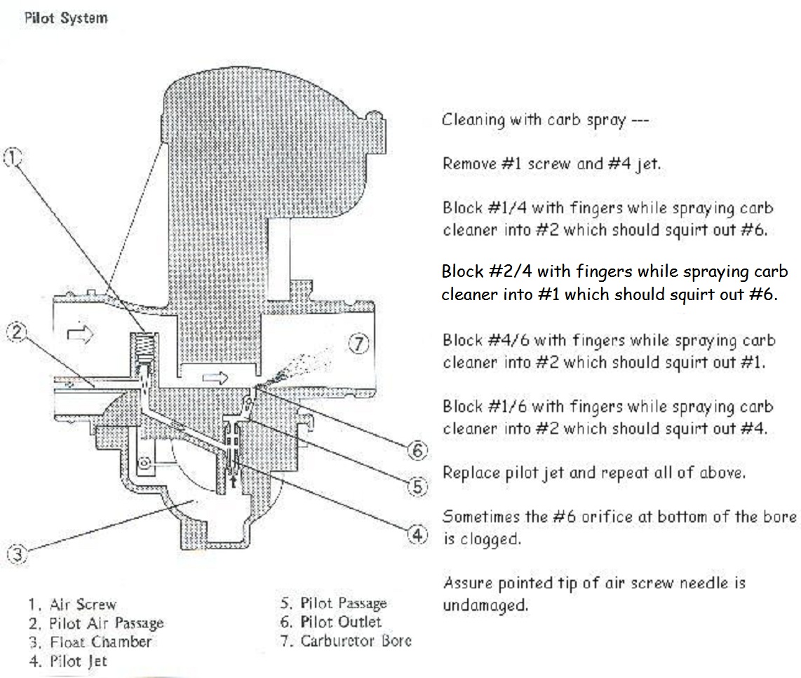

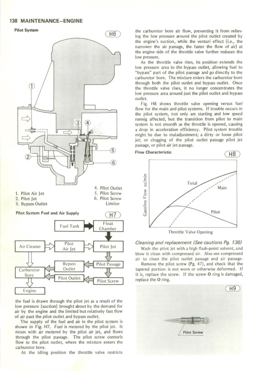

Here are the differences between and air screw and pilot screw round slide carbs. (see attached)
To the best of my knowledge none of the larger KZs (900,1000) came stock with carbs that have both an air and pilot screw. But yes the Suzuki's (750,850,1000) did come with vm26ss carbs with both screws. Some of the KZ650s did come with VM24ss carbs with both types of screws.

A fuel mixture screw affects the overall fuel air ratio at idle because there is a certain amount of air coming past the throttle slide or plate. This air has little fuel in it. This air mixes with the fuel and air from the pilot circuit, which has much more fuel to air than that passing through the throttle opening.
So even if the fuel screw doesnt change the mix ratio in the pilot circuit, by mixing it with clean air from the main carb opening, you can control the overall idle mixture.
Carbs often have more than one way to control the mix at a particular throttle position and this is one example. You can effect idle mix with the screw, or air jet, or pilot jet, and on some carbs, even adjusting the throttle position will affect mix. This happens especially on simple carbs like the tk22. Its easy to see using a wideband.
EDIT: BTW, Mikaw's photo shows clearly how the mixture screw affects overall mix ratio at idle, even if the mix ratio in the pilot system doesn't change.
