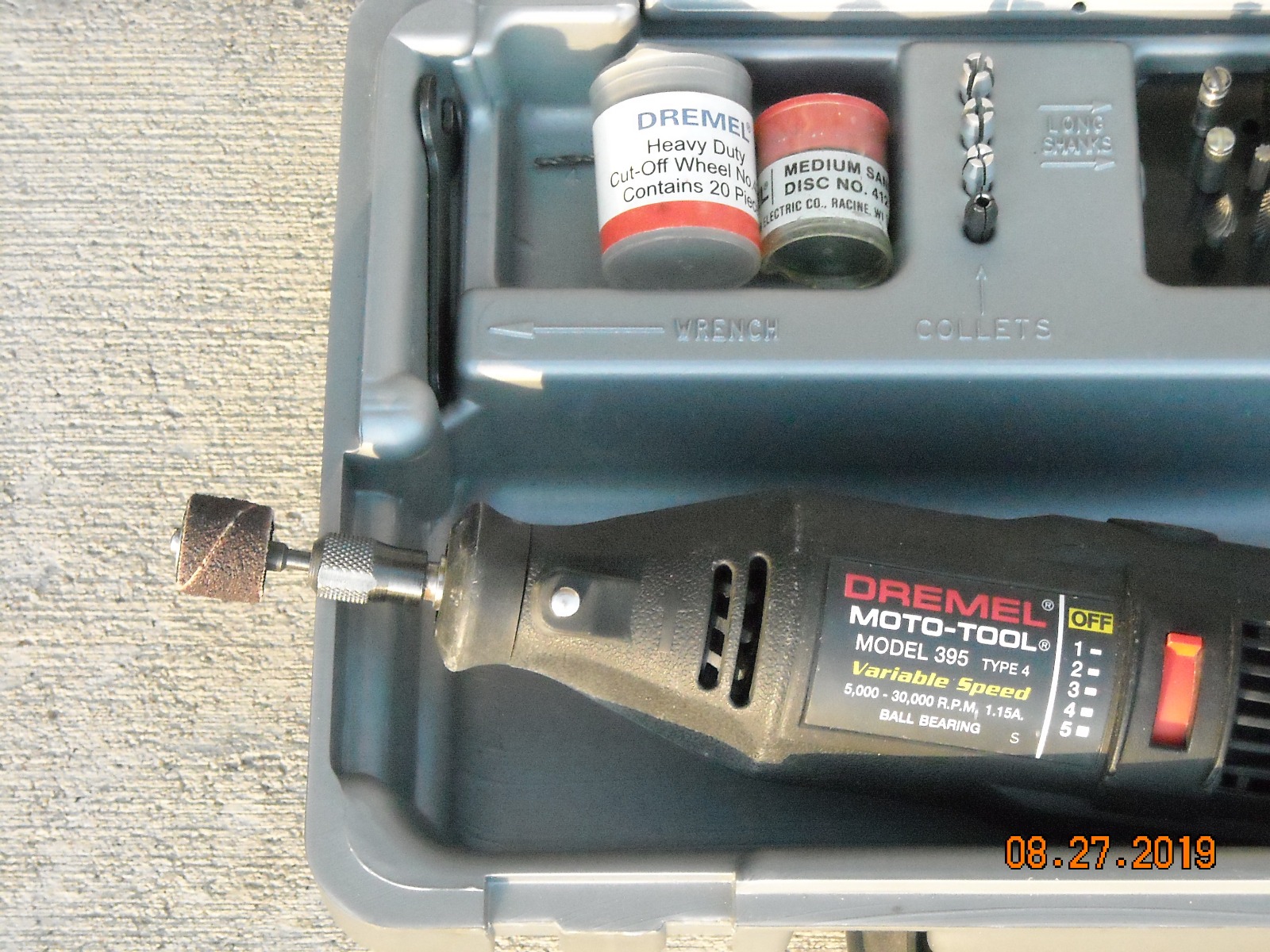

The correct profile of the Z1 carb boot is is a uniform ID which has a slightly tight interference fit with the Flatslides. The bump or ridge is the first thing to be removed. The artsy part is ensuring the ID is uniform as possible. A digital caliper is necessary and is your friend as you slowly remove rubber material. Measure the ID often till you get the hang of it. You are going to remove quite a bit of material from each carb boot before you achieve a slightly tight interference fit between Flatslides and carb boots.
The Dremel worked well set to the 2-3 speed setting.

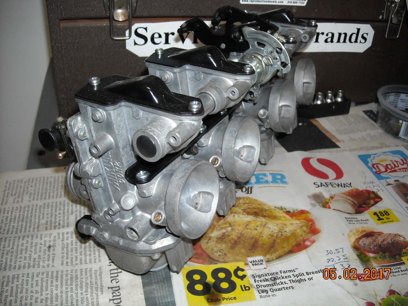

Sorry to read the flatslides have the same exact behavior in the milled out Z1 boots, e.g. hanging idle. That cured mine but lets move on. Looking back this is an interesting photo. I replaced these O-rings when I cleaned and rebuilt my set. Find the tube extending into the carb bowl, then move up and you will see the o-ring. I know you have beat the vacuum leak theory to a pulp but its probably worth shooting the joint where the o-ring resides with WD-40 or propane.
Note the picture shows my air screws position notes written on the greasy newspaper when disassembled 3/4 turns out
