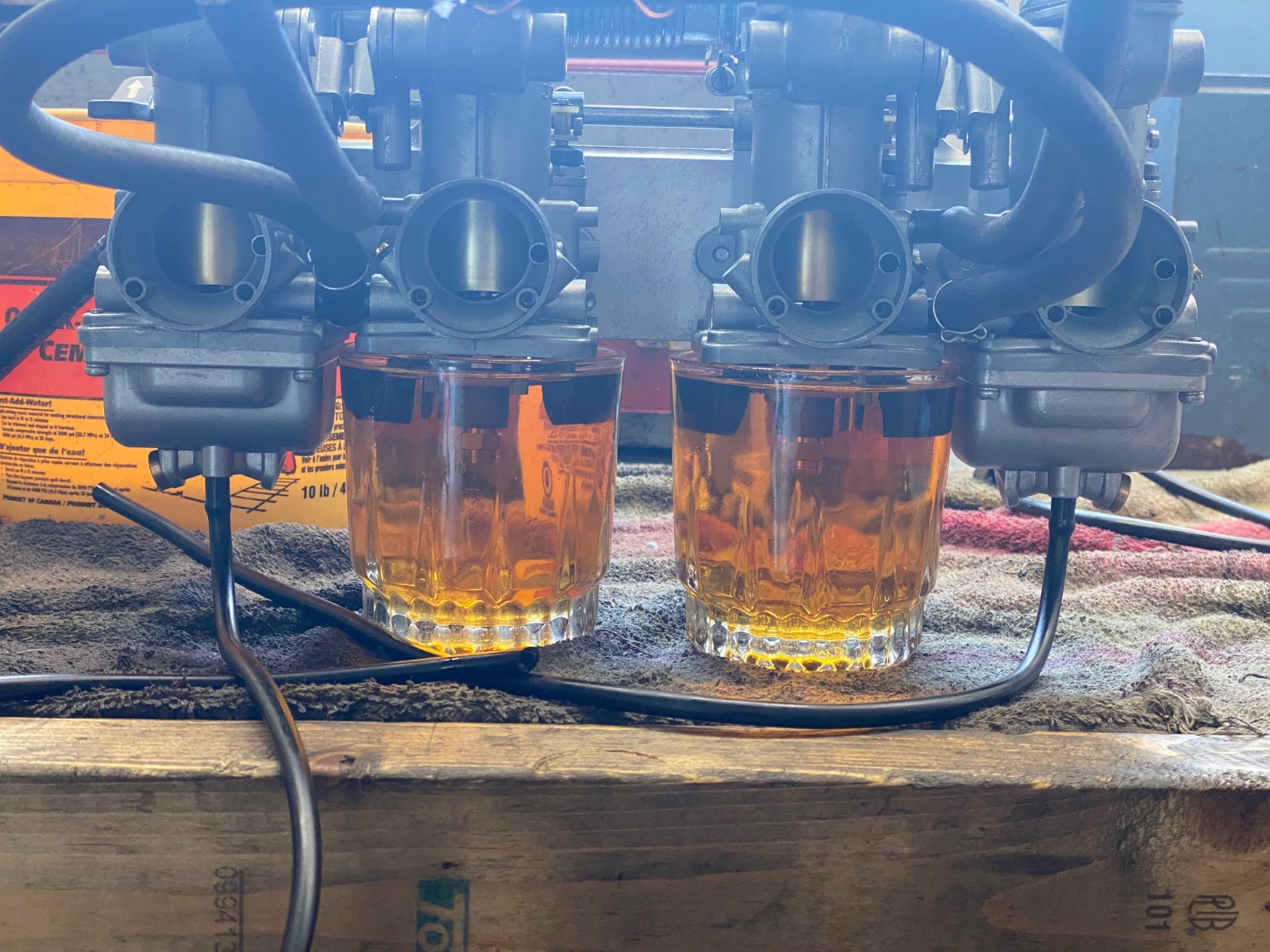

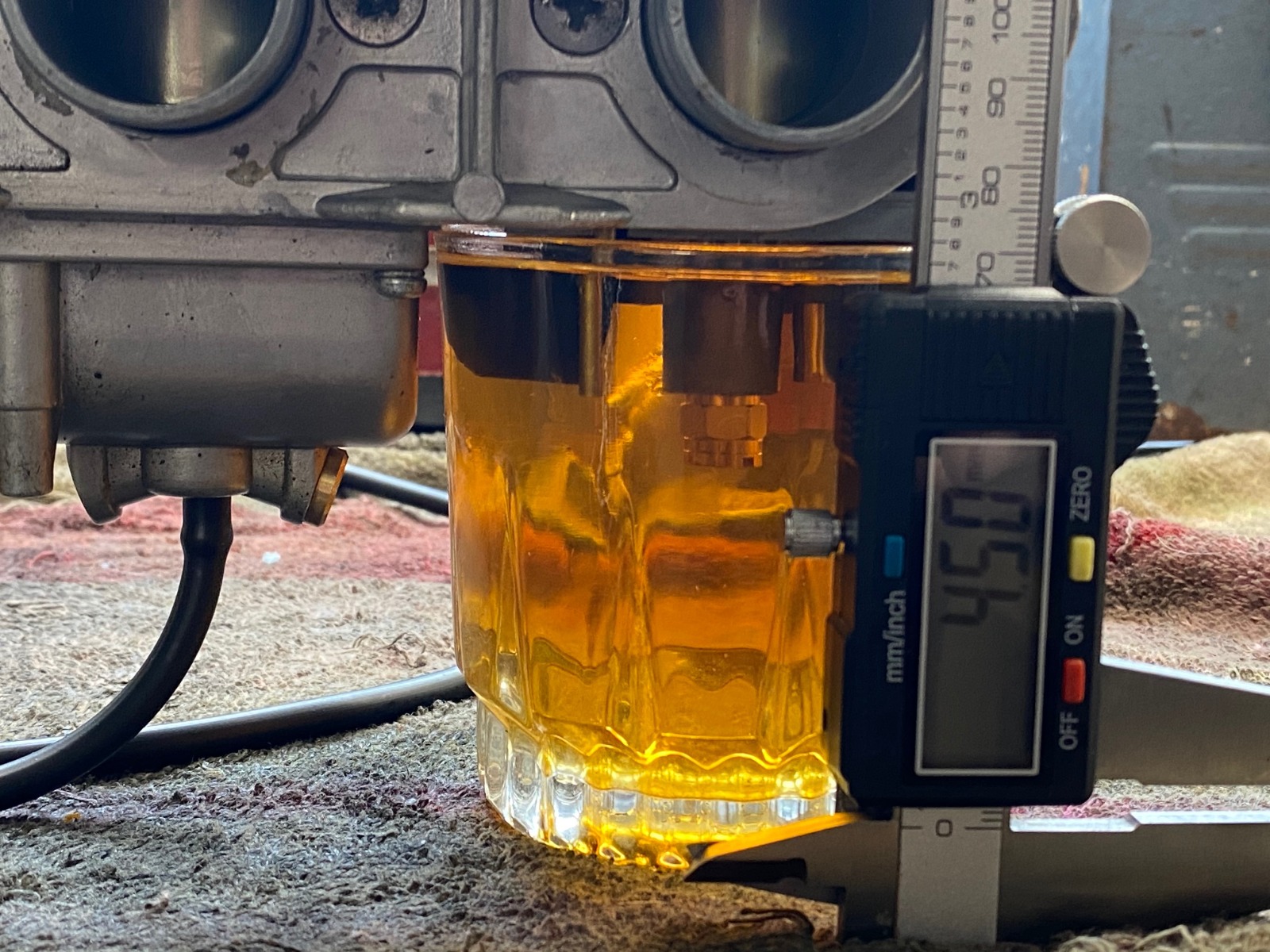

I had to do a head gasket change on one of my Z1B's.  During reassembly I decided to check my carb floats while the carbs were off the bike.  I used the Slmjim method, which I have found to be much faster and cleaner than using a cleartube.  I think Slmjim's method is a significant innovation for checking fuel level for carbs off the bike and would recommend we pin this thread to make it easy to find.
Rather than do one carb at a time I decided to do two.  I would have done all four but couldn't persuade my wife to give up more than two glasses to this project, so....two at a time was the best I could do.  For a fuel supply I used my Motion-Pro temporary tank that I hooked to the carbs.
First I pulled the bowls off the outer two carbs, #1 and #4.  You can see the setup below.  My goal was to measure the gap from the top of the fuel to the top of the glass and hopefully get it set at 3.5 mm, plus or minus 1.0 mm.  The second photo shows how I measured the gap....with a micrometer.  I measured to the bottom of the miniscus.  The third photo shows the middle two carbs after they had filled.  All of my carbs measured 4.5 mm, which is a bit low but within range.
