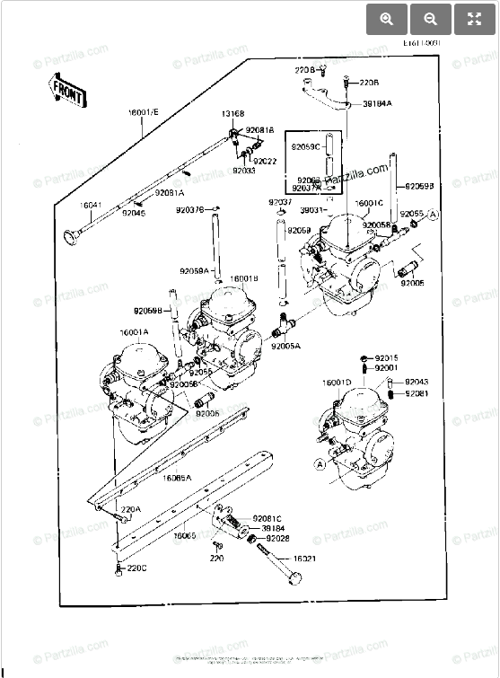

Hey guys can anyone identify these Carbs for me i know they are mikuni but i cannot find a model.
Thank You!
Thank You!

Looks like
cv34mm
cv34mm

i cannot find these carbs anywhere lol.

Why do you need to identify a drawing?
Edit: they could be from an 82 or 83 KZ650-CSR which had Mikuni BS32 carburetors. see diagrams at Partzilla.

Try searching Mikuni BS 34
Which year and model did they come from? Why do you want to find them?

The tops do look like 32s.

I have an 83 csr 650 and im just wondering what carbs they are.

Also I'm diagnosing a high idle situation i am dealing with and knowing what carbs they are might help.

Mikuni BS32's
Have you replaced the rubber intake boots that attach to the head? That's a very common location for vacuum leaks.
