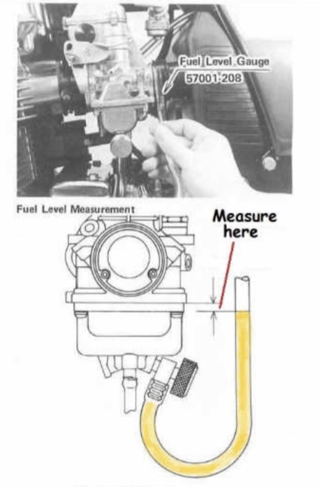

Have you checked gas float level with clear tube test?
