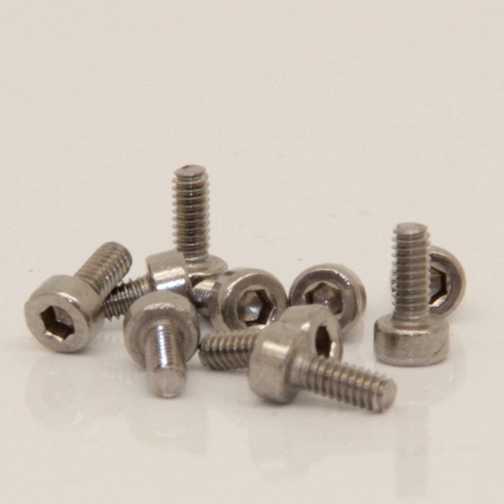

Thanks for the reply, I had another question: pan screws for the carb. My user manual says Pan screw 5x14, but Z1 and bike bandit say 4x14. Z1 says that their replacement hex heads would also fit. Is this true? My concern is that the hex set replacement is only about 7 dollars, but shipping is 14. I would hate to order it, just for the screws to not fit. Do you have a go to piece when replacing hardware?

Thank you Scirocco. I will head to the hardware store later!

I also use stainless M4 allens. Some of the holes need a cleanup with a tap sometimes, due to not being tapped all the way, so I just clean them all.
