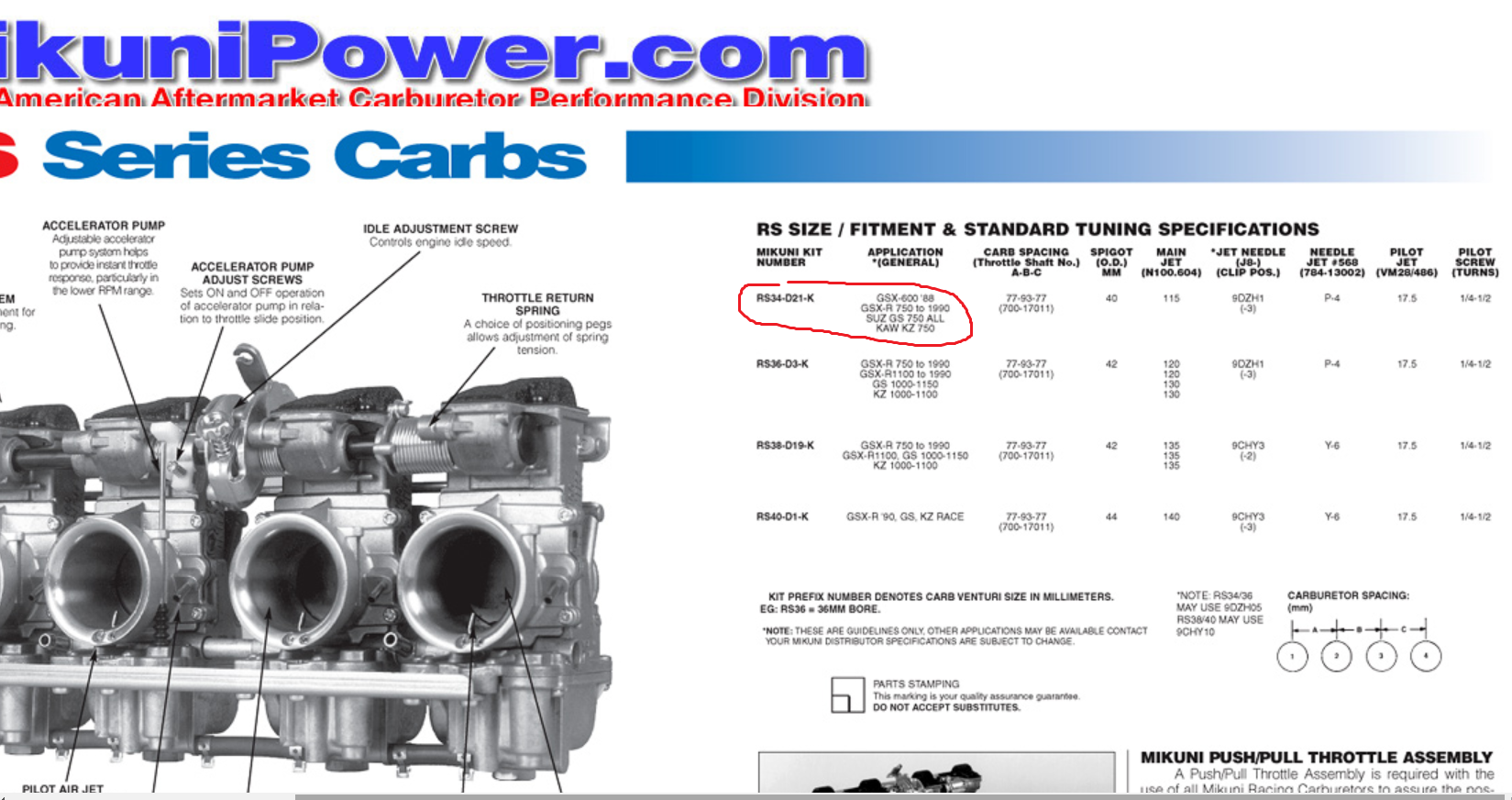

I'm going to buy aftermarket carburetors to inprove a little bit the performance of mine 1982 KZ750E, i've seen the Mikuni RS 34, someone have already install they? What's your opinion?

There was a thread here recently where this same question came up. The answer is that RS34's are way to large for a 750. Mikuni BS34's would be better. They came stock on a bunch of 1000cc bikes so they will flow plenty for a 750.

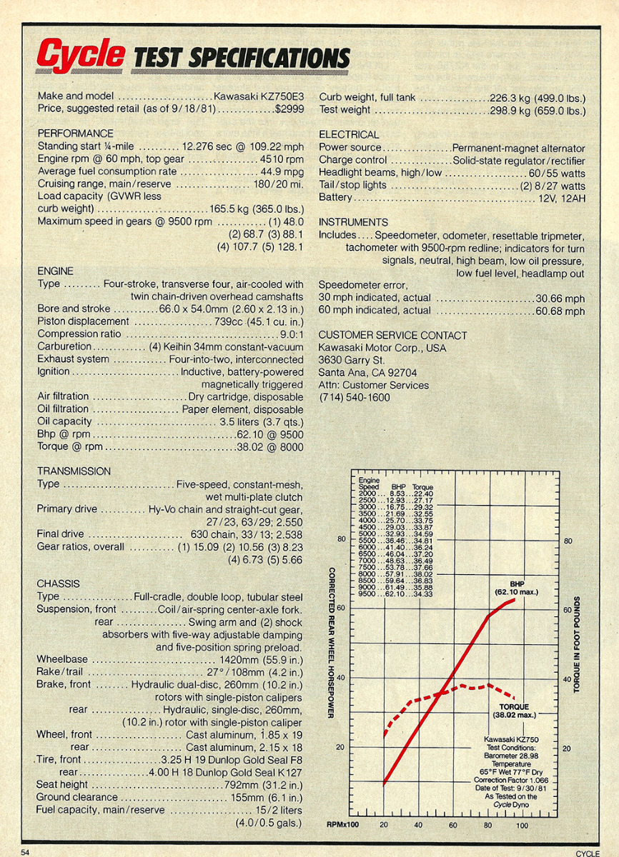

No offense intended, but before you try using different carbs I would urge you to first see how well your bike performs today. If it is not delivering the performance you expect there is most likely something other than carbs that are the problem. Notice in the road test shown below the stock KZ750E ran the quarter mile in less than 12.3 seconds –that’s pretty quick. If you bike doesn’t run that quick I suggest there are many areas you should look at before worrying about changing the carbs. If, on the other hand, your bike already runs that quick there’s a lot more than just swapping carbs needed to make it run much quicker. Ed

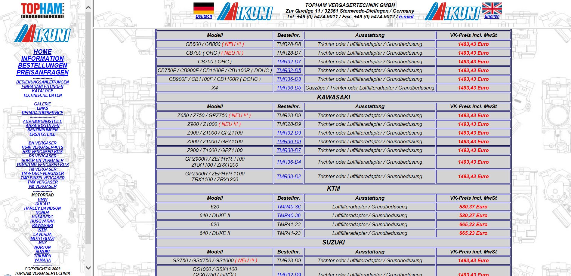

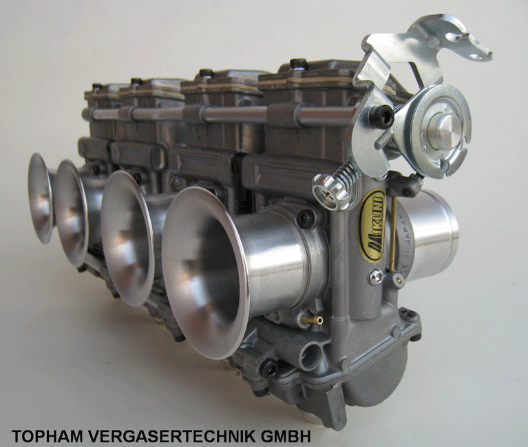

TOPHAM Germany listed a brand new Mikuni TMR 28 set for the Kawasaki 650/750/900/1000 bikes but it´s a little pricey!!!
