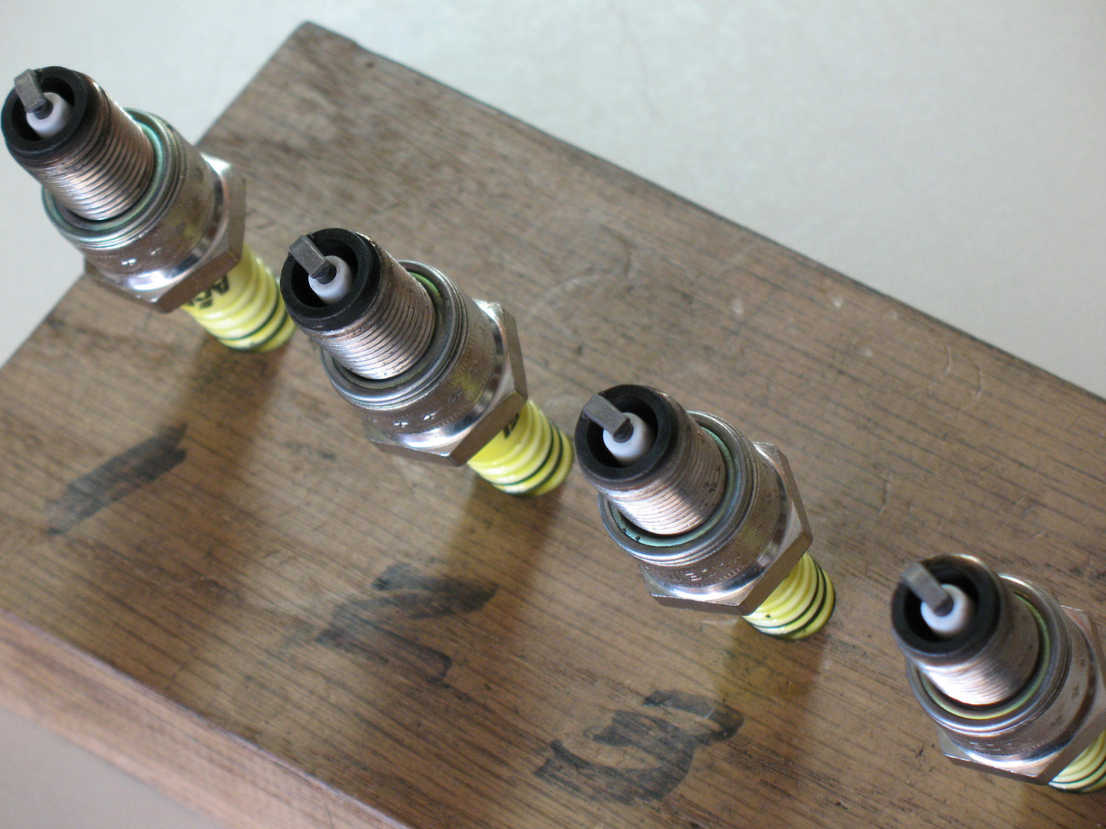

New spark plugs after 100+ miles with 17.5 pilot and 0.7 air jets, using 93 octane E10 gasoline:
Went through another half-tank of 91 octane (Non-Ethanol) premium, and added 87 E10 to top off.
If she likes it, will be 100% 87 E10 thereafter.
