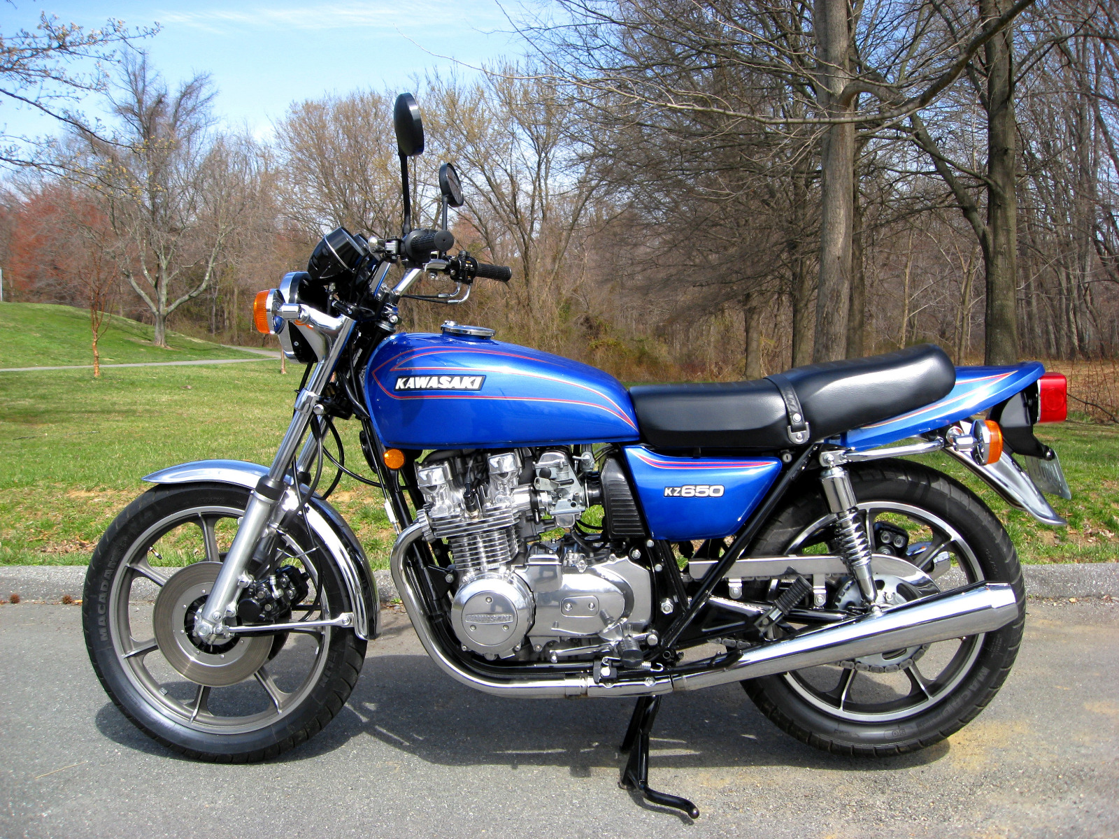

BTW, I own a 1977 KZ650-C1 (pictured below) and have owned and tuned it since it was new. I've put 62,000 miles on it and have always done my own maintenance. KZ650's are really great bikes! Ed
