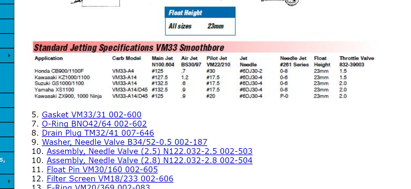

- Posts: 23782
Re: Good deal or not ?
16 May 2019 06:42

Thanks Steve for the Standard Jetting specs but I have read a lot of your posts and I deduct that 1.5 will be too rich for my stock 1000 if its too rich for yours ?
I am looking at a parts bike right now, has not run for 10 years. A 1980 KZ1000 LTD and its $700. Its a complete bike and the engine turns but I don't know what carb it is.

- Posts: 23782
16 May 2019 07:38 - 16 May 2019 07:40
The 2.0 slides were too lean. I had a flat spot just off idle I couldn't get rid of. Had to run larger pilots to compensate. Mileage was crap and Davio found some 1.5's and sent them to me as a surprise. Cost him $100 but wasn't looking for payment. I sent him 4 $25 payments but it took a while to do it. Made all the differance. Went from #70 pilots down to 17.5, back to 1.0 air jets and 127.5 mains along with correcting all the holes drilled by the PO. I'm getting 40+ MPG on the FWY and the bike runs great. Still a little rich in the midrange and will get 125's today to wean it out a little bit more. It has to idle a little higher and I can live with that. I'll post the results in my thread.
At $150, BUY THEM if you can and if you don't like them, sell them here.
